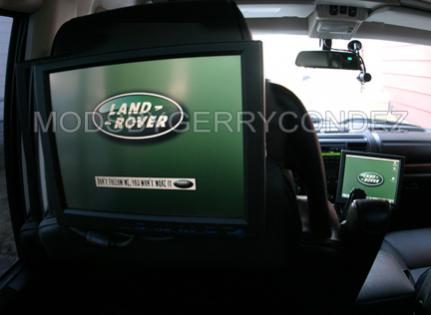

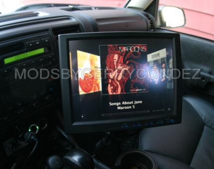

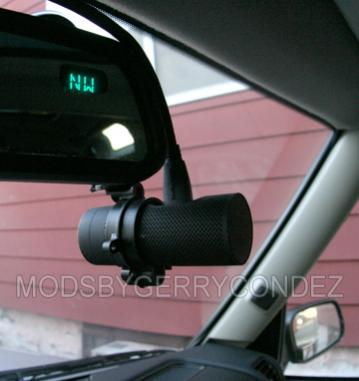

It functions as DVD player for 2 to 3 separate monitors. 1 front and 2 at headrest simultaneously or 2 movies playing same time with separate audio out. Itunes player scroll library by touch. 5.1 Surround. Internet capable through broadband usb connection or WiFi via hotspots. Use iChat, Yahoo Messenger or Skype with video. GPS capable with RouteBuddy but have Garmin already, Realtime video capture through iMovie via firewire camera or iSight. Touch screen keyboard, no external keyboard or mouse. PDA controllable and HotSync. Great for my kids. Cheers - Gerry

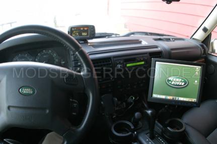

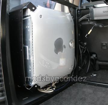

Hi whirk, The system is a Mac G4 dual 1.42 tower. (photos attached) So its actually a work station inside my disco. The 3 touchscreen VGA computer monitors are very sharp for viewing movies from different apps like quicktime or iTunes. You can set it up as extended or mirroring so all can watch or just the people at the back seat and still use another apps in front. You can view 2 movies at the same time going through separate audio channels.Monitor in front seat can be adjusted to face the passenger side which also is a plus considering you can avoid glare.
An example is you can browse iTunes library in front heard from the system output though the existing land rover speakers, back passengers can watch 2 different movies from the 2 monitors behind headrest, still having all separate audio channels. My kids just have to use headphones wired or bluetooth. Another external firewire DVD player installed under rt passenger seat so I can change the disc and not go to the back of the car.

Realtime movie capture trough iSight or a firewire camcorder via iMovie or Media100

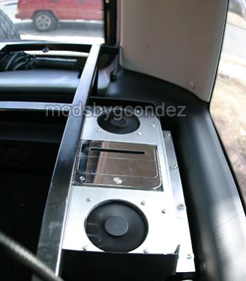

Technically its just a workstation installed and ready for any upgrades. I also designed a way to push the heat down inside computer since its orientation is unusual. Never had heat problems anyway even summer time. The hardest part was fabricating the parts to hold the computer and the monitors to tilt up and down (back) and pan and tilt (front) plus quick release. The VGA cables are thick and had to be run to the front monitor. The computer has a vibration mounts works flawlessly since it was installed (3 years and counting). Never skip a beat unlike the cd changer. Movies from DVD or MP4. Another yet difficult process is adding an pure sine inverter to power them all. Since the VGA monitors are 12 volts, powering it through the inverter with an adapter eliminates noise from the car electronics. The only critical part is the power consumption. You'll have no problem when your car is running but to power a 280 watt computer will last you only an hour and a half if engine is off. I run dual battery so were good watching a full movie while parked. (never happened yet).
Where are the keyboard and mouse? All on-screen. I'm sure that there are more uses other than entertainment, but I'm happy so far with the results.
