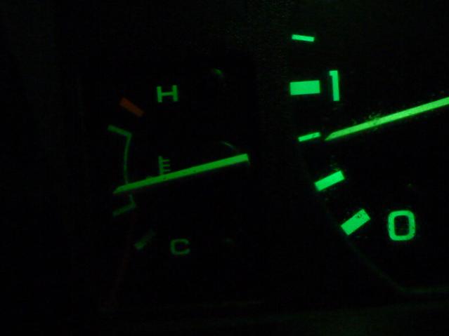

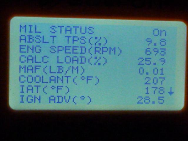

3. When you say "pretty hot", do you mean that temp gauge goees above 9:00 position on the gauge? The D1 is designed to show from 8 - 9:00 for a wide range of coolant temps, like 135 - 235F. If above 9:00 you are overheating and make no mistake about it. he best way to know what is going on is to attach a data reading code scanner, or an Ultra Gauge, to the OBDII port. A separate coolant temp sensor tells the ECU how hot things are 1 degree at a time. But I am not sure if you have an OBDII port under the dash, if not, best you can do is a point and shoot IR thermometer.

Pix attached of old vs newer water pump, scale build up, temp reading vs scanner reading. Download RAVE so you will have full set of service manuals.
