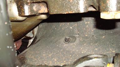

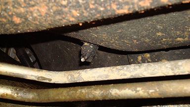

Take a pic of them and post it please. That way we all learn much faster.

This simple fix is also one of my VERY favorite Disco practical jokes to play on someone who DISCOvers the wet carpet prob. No harm, no blood and just a wee bit funny.
Here's a few pics of both sides for y'all...

I think mine got plugged up this weekend..going to clean them out tomorrow..thanks for posting the pics cosmic
EDIT: haven't posted on here in a few weeks..just realized theres a DI and DII section now..are the drains in the same place for the DII?
