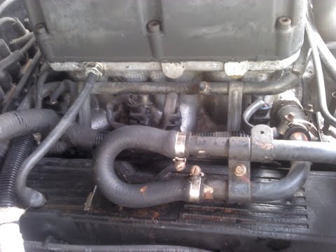

Previous owner may have disabled heater by this simple bypass. If so, you won't hear any bubbles of exhaust gas circulating in the coolant (heater core) from a bad head gasket. It is sort of a built in warning system. Might be something to check into before purchase, if bypassed.
