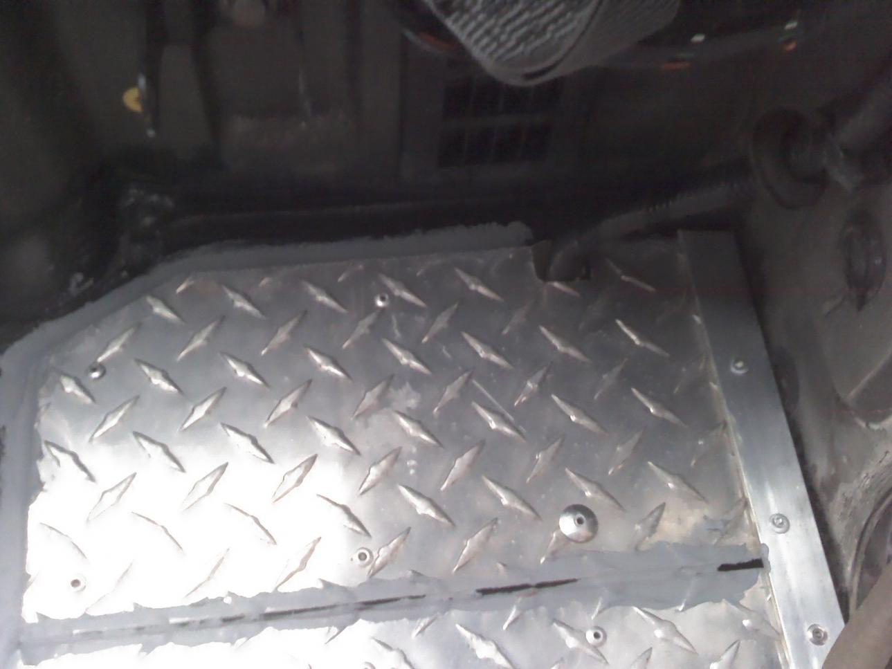

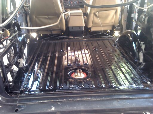

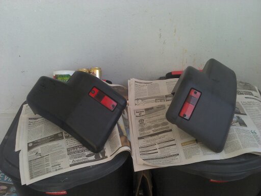

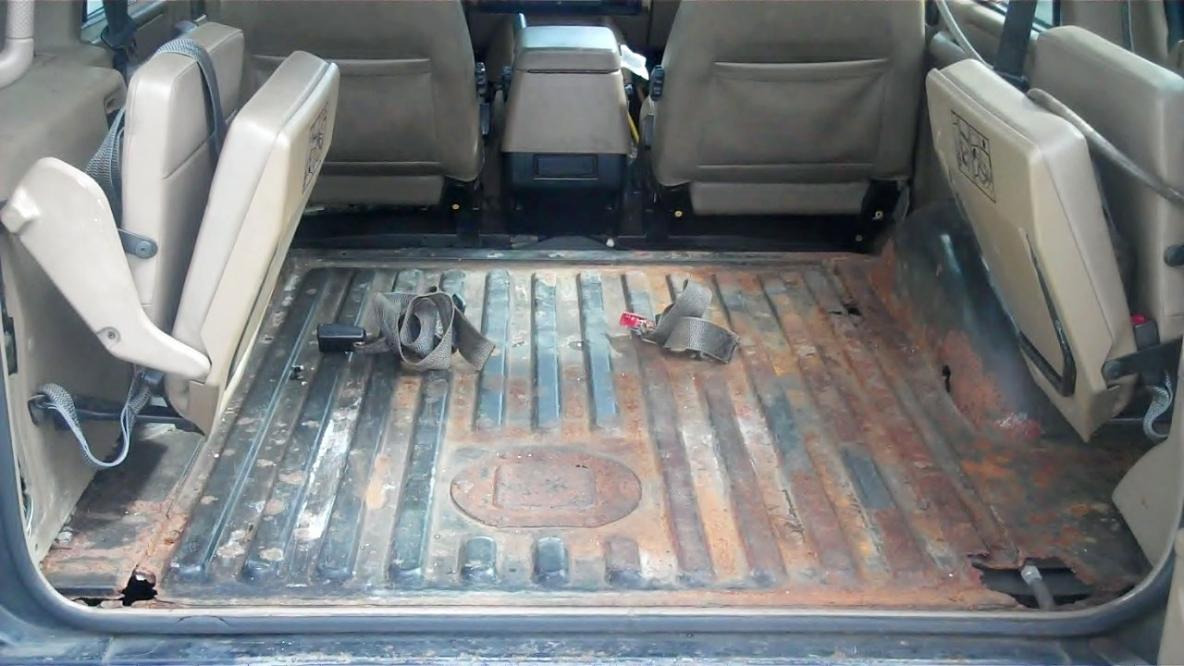

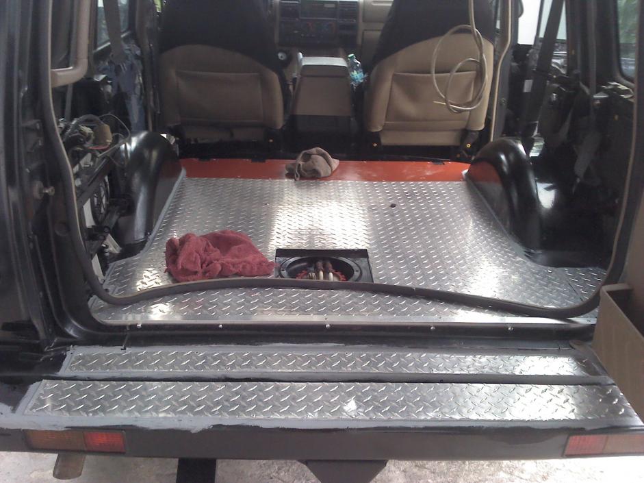

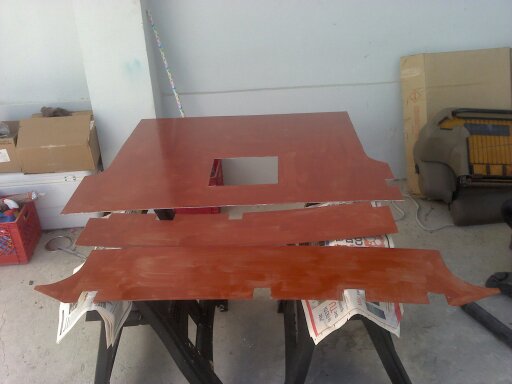

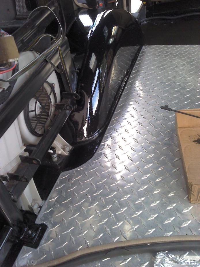

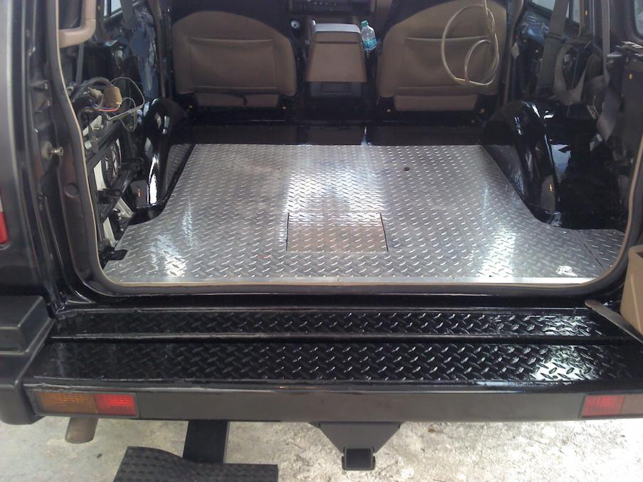

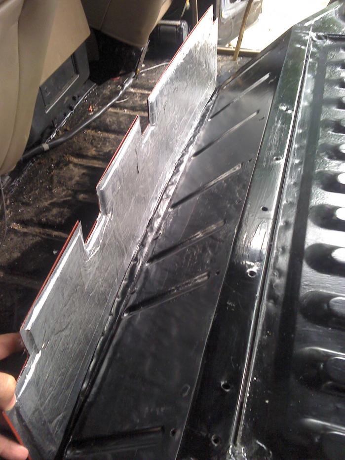

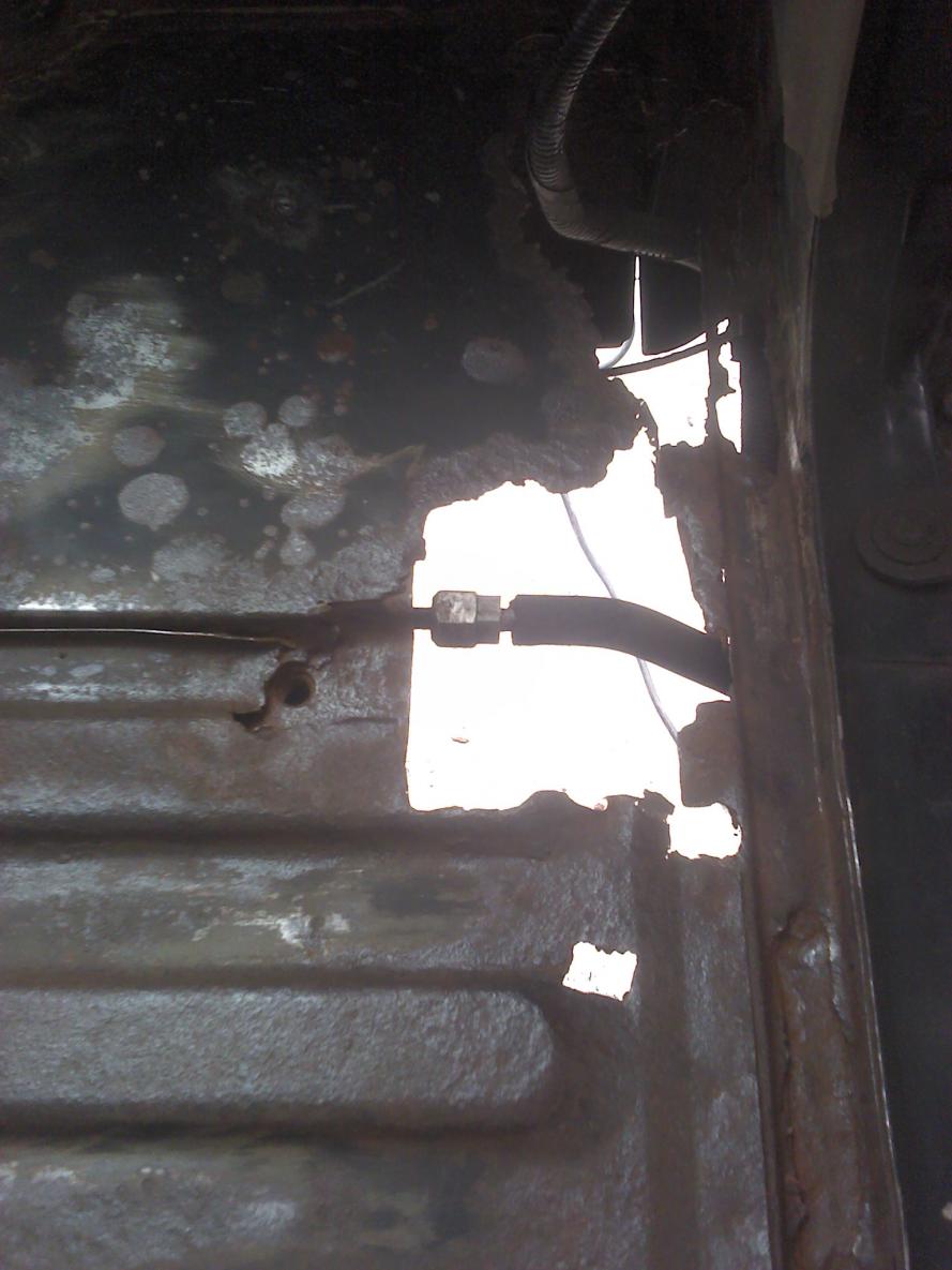

Finally finished except for fuel door and a little caulking. Grinded everything. Rust proofed chemical bath. Fiberglassed holes. Prepared steel and diamond plate or floors.

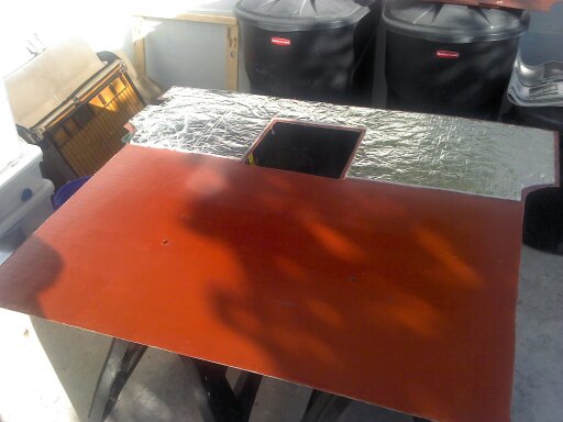

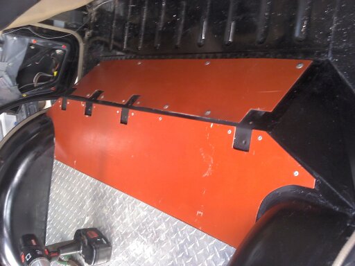

Primed back and front (except front of diamondplate). Insulation added. Fiberglass painted for covering.

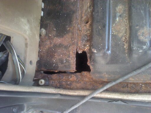

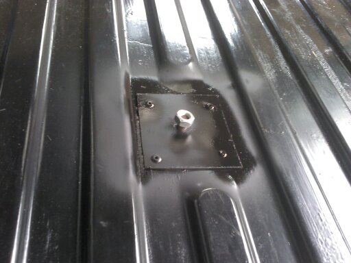

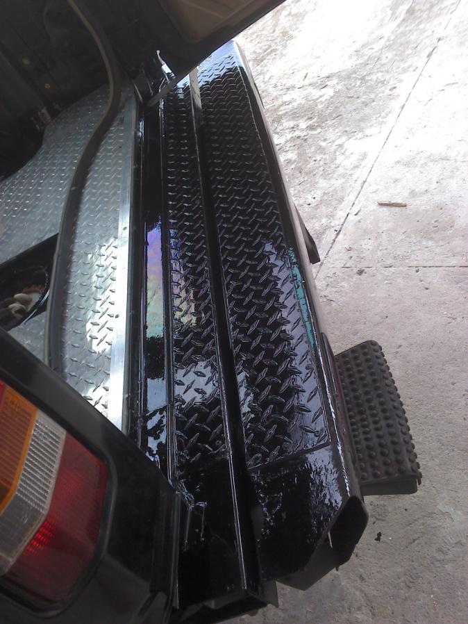

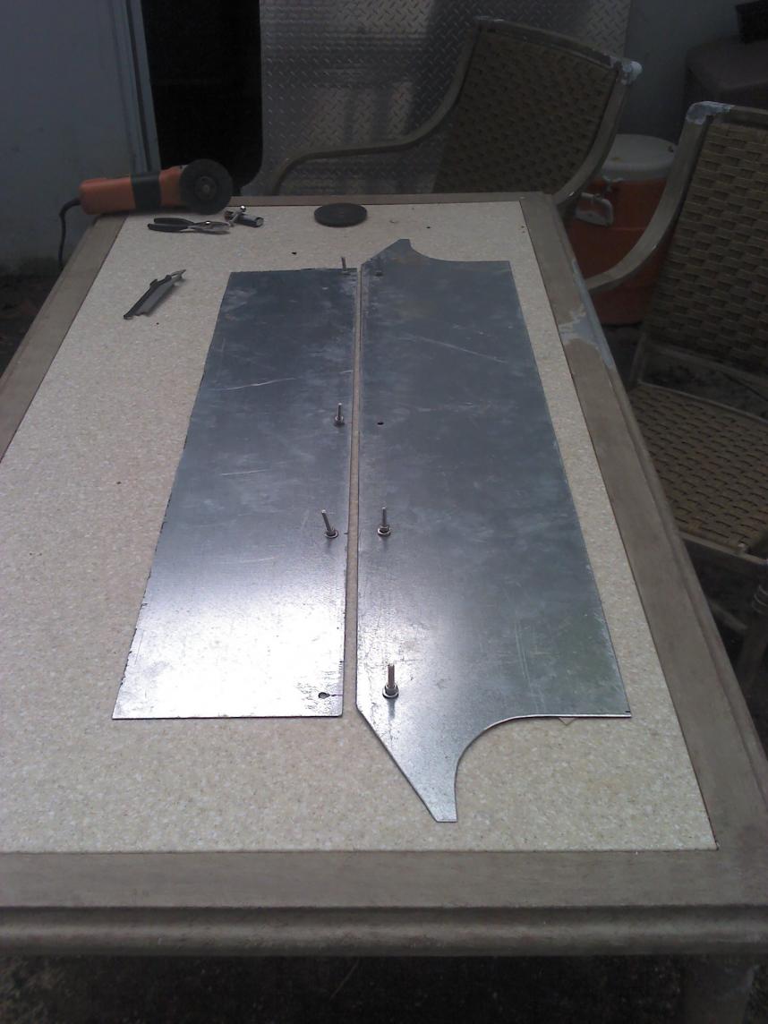

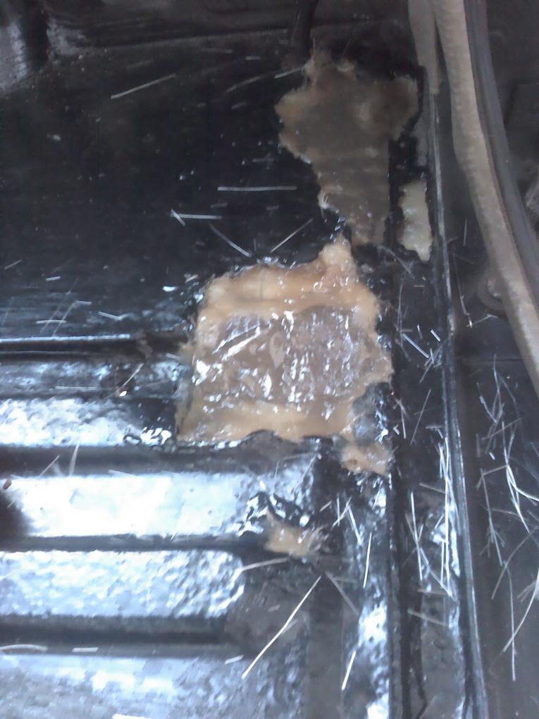

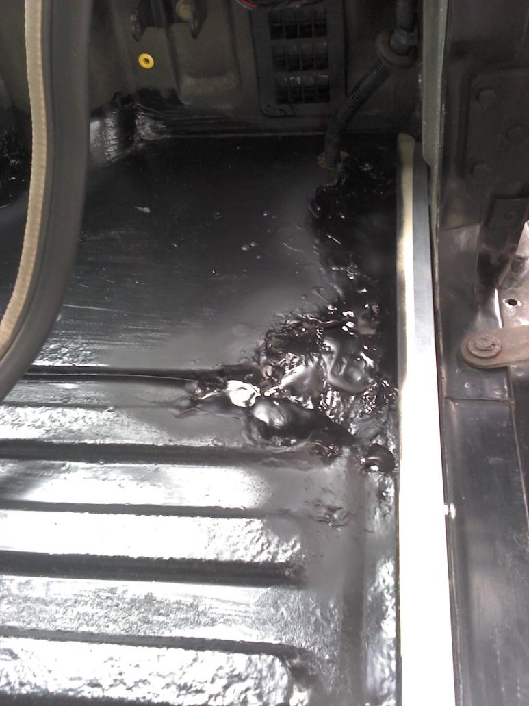

Crack in the floor where the seatbolt bolt/undercarriage body bushing fits. Did a little fix while I was there.
Cutaways on the floor panels to reuse existing seat belt fittings. Change of design.

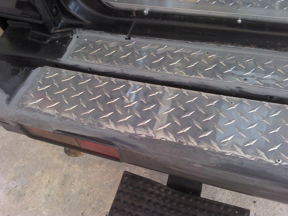

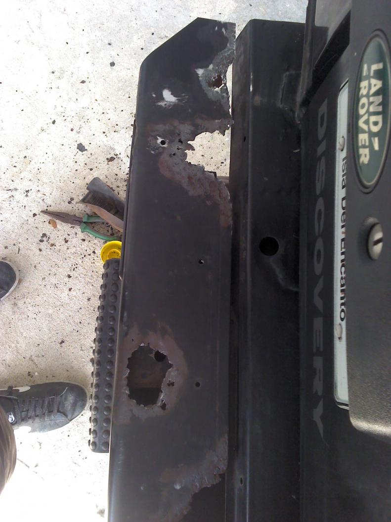

Bumper looks terrible. Fixed it with the scrap diamondplate....tooo shiny.
Fixed that bad corner with an extra piece of diamondplate.

Short of a good welding job which I cannot do myself I am pleased with the results. Cutting metal with a hand grinder accurately isn't easy and a shop with plasma cutter would get much better results. But I feel it looks good, is consistent with the overall finish I'm looking for and has been a fun experience. Overall I think it's really sound. I spent a lot of time treating the rust right and while I don't expect it to disappear I do think I controlled it for now.
Roof and front next.

what caused your rig to rust so bad if you are from a warm climate? Nice work though.

i live at the beach. everything rusts in front of you. First half of its life I had her in NYC. Salt, grime, etc.
But what really does it is not stopping the leaks in the roof at their onset.
