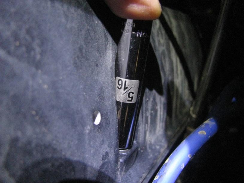

I've found that a 1/4 drive 5/16 deep-socket fits better and is easier to find.

...or a 5/16" 1/4 drive socket and an extension.

yup.. 2.50 for the standard vs 3.79 for the deep well. Gotta save a dollar here and there when you can..
