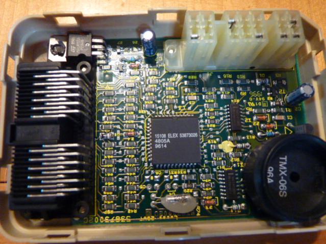

Sorry - here's the test procedure you can do at home for the MFU.
Pix of internal as well. It is a small box on the back of the fuse panel, times lots of things in the truck, and is not really something to tinker with unless you like component level printed circuit board repair. Not a well designed unit, I replaced one because it had melted a hole in the case by overheating. Change out interior dome lights and cargo light bulbs to LED to improve life of the MFU (reduces power that must be "dimmed").
