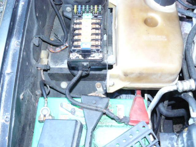

1. Does tach work? If plug in lead on back of alternator not plugged in, or alternator is dead again (rebuilts from parts stores have short life) - tach won't work.
1 1/2 - DISCONNECT (-) BLACK WIRE FROM BATTERY

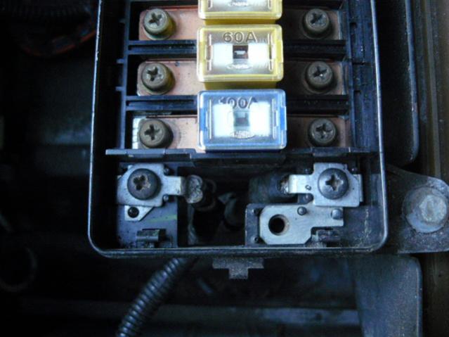

2. Open underhood fusebox near battery. Find two wires at front. Clean and tighten these conections. This is where alternator power gets to the truck, and where the smaller wire runs over about a foot to the (+) terminal of the battery. Also clean and tighten that connection. That little short wire is what applies charge to the battery.
3. At that same area see the square fuse links. They should be clean and tight, and not blown. The one marked 100 amp is the main fuse so to speak.
4. Clean and reconnect (-) wire to battery.
5. Measure battery volts - should be 12.6 - 13.2 just sitting there, maybe a little higher.
6. Turn on head lights. Battery should be able to run head lights and not drop below 12 volts. If it drops like a stone, dead cell, or not fully charged to start with.
7. Crank truck, even if you have to jump it off. At idle should read 13.8 - 14.2 volts across battery, with nothing on. Turn on stuff (lights, AC, wipers, etc.) and voltage may drop, but should not go below 13.4. If volts drop under load you either have a weak alternator, or more corroded conections (like main ground bond at end of (-) battery cable on frame) to deal with.
8. If truck will run, and battery gets charging volts, but dies overnight, you have a drain (something stuck on) to find.
