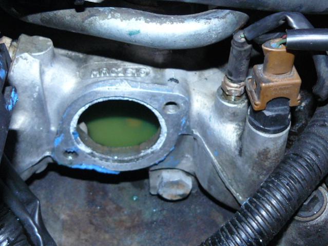

3. Might also be the coolant temp sensor. This is not the gauge sender, which you have discovered is not very accurate, it is the one next door that has a square plastic connector on top with two wires. The ECU reads it to determine coolant temp and will fatten pulse width of signals to injectors to send for fuel. Don't know if you have a bad one, or a wiring issue. On my scanner, the coolant temp makes sense normally (it is ambient when vehicle has been parked over night, rising to thermostat temp as vehicle warms up); but if I unplug the sender connector it reads -40F on the scanner. So if you have a scanner, you can observe the coolant temp in digital fashion when the mayhem is happening.
5. Pix of D1 intake with coolant sensor on right. Also, for a cheap test, when this happens, spray the fuel rail temp sensor with brake parts cleaner or cold water and see if that makes things return to normal quickly.
