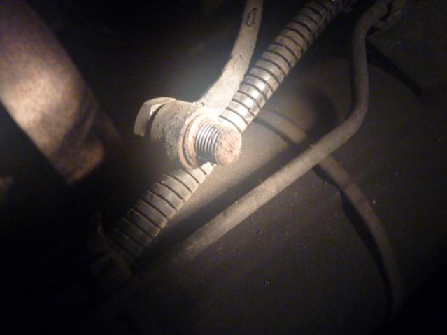

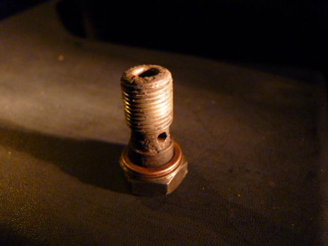

Transfer case drain & refill, transfer case inspection plate re-seal, clean out banjo bolt on diffs and transfer case, when they get mud buildup the vent is blocked, so evaporation of the fluids builds up pressure, leaks diff oil out the wheel seal, etc. Pix of bolts. The vent lines go up to those little sheppard crooks at back of engine compartment, but the rear one is near the transfer case, so it more eaily gets flooded when skinny dipping in the Rover. Inspect frame drain holes for clogs, flush out.
