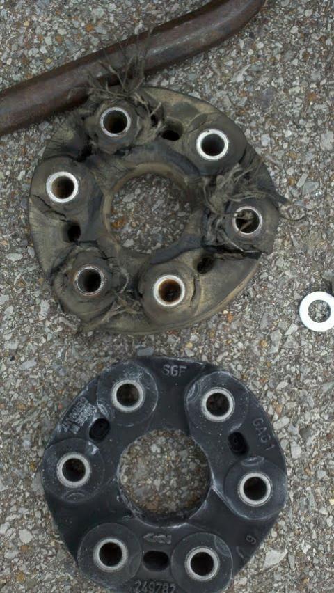

So I finally got around to replacing mine. It took me 30min to switch them out. Also replacing it eliminated 100% of my drive vibrations.
Heres a picture to show how bad mine was.

Did you make sure to install the replacement with the directional arrow pointing in the correct direction, otherwise it can fail.

I never saw a directional arrow. I just installed It the excact way the old one came off.

If you have the old one, look and see what was the front of it and look for the arrow, then go check your's. Problem is, they will install either way but are designed to go primarily in one specific direction.

Ok just went out and checked. I found something resembling an arrow and the markings were to the front of the vehicle before i removed it so the arrow pointed clockwise. I installed the new one markings to the front and the same arrow shape points clockwise which I assume that the rear driveshaft turns clockwise(point of view from front of the vehicle). So Im 99% sure its on correctly.
There were also 6 arrows on the side alternating directions that lined up with the bolt holes. I assume that those are to show which direction the bolt is installed in that particular hole. If so then those are right.

The old one looks really bad. You're lucky it did not totally come apart while driving. How long was it like that?

Ive had the vibration since march last year , but didnt discover that was the problem till October. Ive put 13,000mi on the truck since march so it really is amazing how long it lasted. but im glad to get it changed out.

That is amazing, during that time frame did you ever get under the vehicle and look at the rotoflex or driveline?
My son drove my Disco for a few months last winter. I will never again allow that. He was in slick snow and ice one night, spun the tires really bad and tore up both my RotoFlex and tore one of the holes out of the mating flange, so I ended up buying a 98 rear D/S that did away with the rotoflex since my rear flange was trashed.

Yeah. Im so glad it didn't fail and come through the floor board in the back. Im always under my truck but never put vibration and rubber thing with a few cracks in it together till it started getting really bad.
