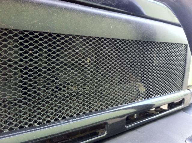

This weekend I finished my Saudi grill and we took a trip to Diamond Lake, OR. Here's some pics for you guys:
I used a dremel to cut out the inside and then sanded it with a sanding block to smooth and straighten the edges. Then I used black gutter guard, set four bottles of coolant to weigh it down, and 4 mini C clamps so the edges lay pressed perfectly flat to the grill. I laid a thick but uniform bead of clear 30 minute epoxy on the edges and it came out very clean and well secured.

Eric. Better pic of the grill work? The original has a rubber seal between the grill and the surround. I'm thinking of creating a space to put something like that in. Also, I don't love my grill (black painted hardware cloth) so I may want to make it so I can swap it out if I can find something better.

Yeah Eric....closer pics!!!......

Sure
My grill isn't in great shape either, but I still wanted to do a good job on the mod. I'll probably get a new grill after this one cracks bad enough and do it again.

that looks great.
