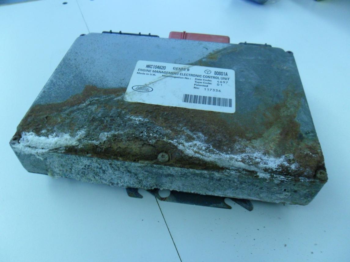

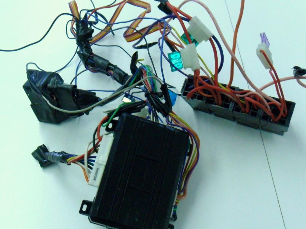

all the symptoms of my issue here certainly made it look like the infamous immobiliser problem. So I decided to take the dash apart to get at the pesky black box....after an hour of honing my swearing abilities to perfection...much to my disappointment....the immobiliser WAS ALREADY GONE ! there wasnt even a wiring harness where it used to be ! Instead, tucked in behind everything was the biggest mess of an aftermarket security system I have ever seen. In my wildest days of pre-high school tinkering I would not have created something as bad as this. Four wires of this mess were were still connected to my truck in tucked away places...so I did away with them and tried to return the wiring to "stock" . Now , this stuff has been attached to my truck since I bought it, so not completely satisfied this was the problem...I turned my attention to the ECU. The wiring TO it looked good, but I decided to remove it just to have a look....glad I did. There was a 2" hole in the fenderwell which apparently had been soaking the ECU for quite a while....the corrosion underneath the computer was unreal ! I was afraid to open it up but did anyway. pretty bad inside too....alluminum oxidation and moisture aplenty. Other than being lightly coated with crap the circuit boards looked ok, so I cleaned it all up gently and resealed it back up. There was actually a hole corroded through the bottom of the ECU !! ( plugged the hole in the fenderwell too). For now the problem seems to be cured (knock on wood) I feel the corrosion in the ECU had more to do with my issues than the botched security system, but glad I got rid of it anyway.

I think I know your PO - Howard J. Muckenfuss - an attorney, and he left a multi-volume set of Murphy's Law in the truck..... amazing that it ran at all. Good, but scary pix.
