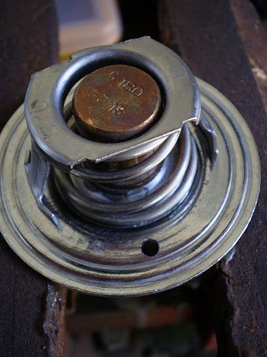

My gauge (and they all read a little differently) comes to almost 8:00 at 130 F, and won't go past 9:00 until beyond 235 F, and it is not linear. I would agree also that no need to wait for warm up by gauge. Now warm up by feeling warm in truck is a different time issue. Engine will warm up faster under power than idle.
It is also correct to say if the thermostat is sticking it will take a long time to get heat. With no stat at all (which I tried), I would only get to 135 - 145 F water temp in summer, that would be less in winter.
So if you still don't get heat "soon enough" you might consider replacing $10 stat (which might be sticking) with either a 180 or 195F, don't use a 160 or you will have too little heat. You also want stat to have a vent device or drill a small hole in it, which allows coolant bubbles to pass.
