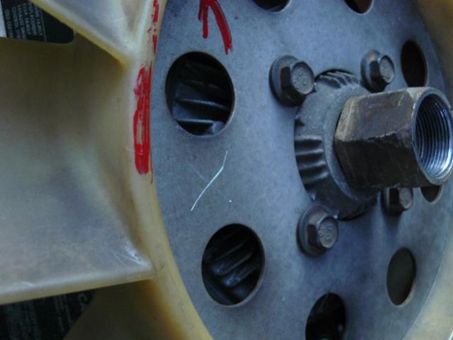

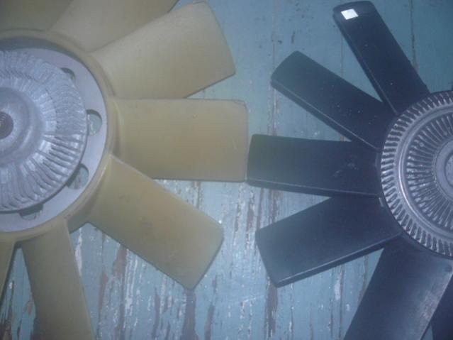

8. Heat will still work. Alt could be the flying lead off the back, it take the frequency to the alternator o count. About 270 Hz at idle.
Tranny cooler - on my 97, there are two, one is a "towel bar" in front of the radiators (BTW, blow out all the leaves and trash between radiators - pull rubber strip to access), and the second is the built into copper radiator on driver side. The oil cooler is on the passenger side. See attached. I belieev the switch in item 5 is an over heat switch for warning light.
I've used water wetter on off road machinery with decent results, sort of a bandaid until we could change out worn out belts, etc.
Most junk yards have plenty of Chevys and GMC, the fan clutch is 6 inch diameter, reverse direction, and screws right up to our water pump. Will have to trim blades.
Water cooled computer - I supported an air cooled ES9000 (IBM) mainframe in the dark ages, so I always assumed they made a water cooled...
