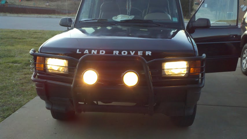

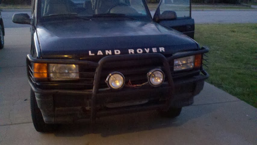

Old 01-11-2012, 08:38 PM
bradical's Avatar
Senior Member
Join Date: Aug 2011
Location: Greenbrier, TN
Posts: 161
heres a before and after. its been a week and it still looks like the day I did it. my roof is faded out to gray, did a small test area back and its back to black..when the rain here clears up ill take before and after pics of the roof..
