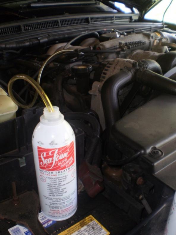

The Pictures for induction cleaning are showing a plastic cup on a tube to which the sea foam needs to be routed. In my car the part is attached to a tube that goes into a black box on the passenger site. So how do i do the induction cleaning? just taking out the hose?

Since you have a "new" Rover, maybe not use Gunk and spring for a BG44 flush see BG Findashop for a shop near you. Most flush systems are better used at idle than at higher speeds, driving to shop, etc. If you do gunk, do it down the street from oil change place and don't drive too far.
They also offer an induction cleaning which will do more than SeaFoam. However, if you want to do your own Seafoam, just remove a vacuum line from oil separator on passenger side valve cover and let engine sip it in. You don't use the whole can, only about 5 ounces. Pour the rest in the fuel tank. Pix below.

You can certainly use the Gunk and the SeaFoam. I have, and it is also a good way to find any exhaust leaks. Since I have a D1, can't speak to exact parts needed for wiper conversion, but a quick search of our site should pop some up.
