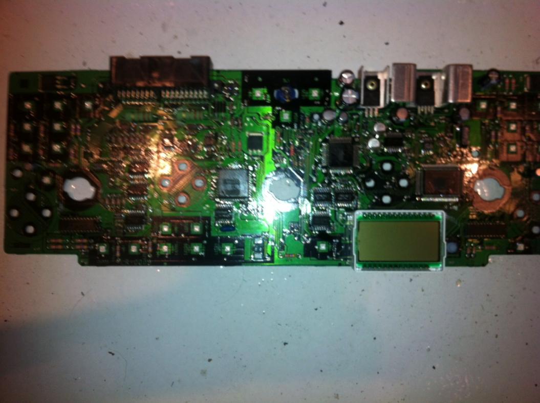

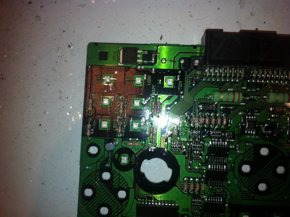

You may be able to tear the panel apart and piggy back a LED to the existing one or replace it but they're actually soldered to the PCB and not through it which makes repair a little more tedious.

Or use your own LED with series resistor and connect to the two wires mentioned above, and shove in the right spot on the dash. But is your LED cut out, or just painted over?
