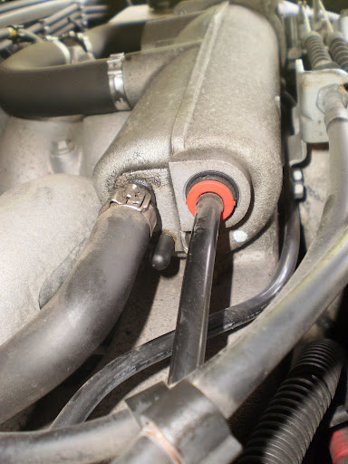

1. Identify the black plug between the rubber crank case vent tube on the left, and the vacuum line on the right.
2. Remove the plug. Make sure you replace with a new one if yours is dry or too loose no longer having a snug fit.

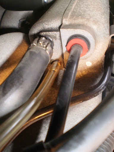

3. Attach the clear vacuum line.
4. Open one can of seafoam and have a helper turn the engine on. Using pliers pinch the line and insert in bottle.
5. Time to suck in seafoam. Control the intake of the fluid to last one minute. You can regulate it without pliers by placing the end of the line just above the surface of the fluid. Remember not to let it last too long or it will start to smog the neighborhood before time. Turn engine off immediately after can is dry.
