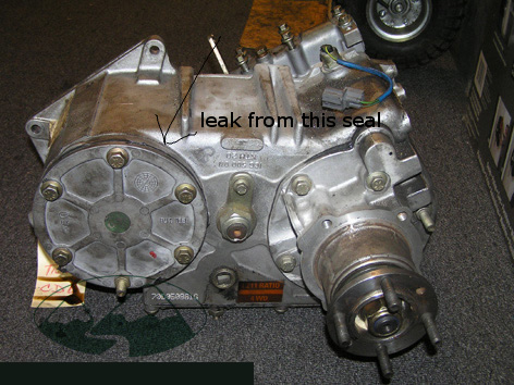

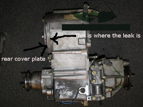

My transfer box was leaking, after cleaning it throughly and refieling it with synthetic 75-140 oil, I found now where it is leaking from. I am not able to find a part number or name of this location. It is not leaking from the seal close to the bolts. It is leaking from the seal close to the housing, top of the arrow in pictures. I didn't even know that there was a seal , see picture. I will appreciate any help

That would be the rear cover plate. Page from RAVE shop manual attached on re-seal method, no preformed gasket used. Seems if RTV works for the inspecton plate it should work here. RAVE shop manual also has exploded diagrams of the TC.

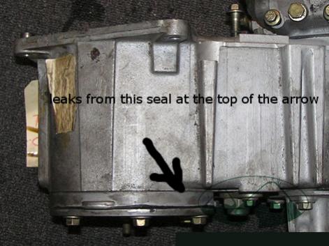

Thank you for quick reply, I went through the manual multiple times and also searched online, the leak is not from the rear cover plate. On my car they seem to have used RTV and the rear cover plate and the seal in clean. There is another seal flush with the housing around 0.5 inches away from the cover plate, which is leaking. I have marked both areas in the picture below.

It looks like a seal, I just don't know why it is not described any where. I used a degreaser and power washed it, which did not remove much, than I took your advise and used gunk gel and power washed it again and finally cleaned it manually and I am glad I did, because the cover plate, which I thought was leaking is not leaking.

Here's exploded diagram, perhaps fax to parts man, item you want would be between part #6 and the case. But if RTV works for the other areas (rear cover, bottom inspection plate), then why not here?
