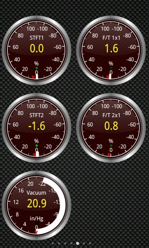

I've been tossing around the idea of getting a Scangauge II for a while now. I have been having some voltage issues and needed to see if my voltage was constant. Locally, they sell the Scangauge at CampingWorld...for $169 plus tax. Since I am "frugal" (read: cheap) I thought I would try the Torque app made for Android and a Bluetooth OBDII device. The best Bluetooth device is the Kiwi, but I opted for the cheapo Amazon device. It costs $25 plus shipping. In this case, I had it overnighted since I love instant gratification. Total cost $45 for the Bluetooth OBDII reader and like $5 for the app. So I have $50 invested in this set up. First, here are some things the Torque app will do:
- Read AND reset codes
- GPS Log Data
- Real time reading of a ton of stuff (will go over later)
- Many different skins to match the Rover
- Video recorder that overlays Speed, HP, RPM,s, etc... (for when we are doing the 1/4 mile in rovers)
- Graphing of captured data
So here is what I know works so far on the DII as far as realtime data:
- RPM
- MPG (instant and average)
- Intake air temp
- Coolant Temp
- Volts (from obd)
- Speed (from gps)
- Engine Load
- Fuel Trim Bank 1 Sensor 1
- Fuel Trim Bank 2 Sensor 1
- Fuel Trim Short Term Bank 1
- Fuel Trim Short Term Bank 2
- O2 Volts Bank 1 Sensor 1
- O2 Volts Bank 1 Sensor 2
- O2 Volts Bank 2 Sensor 1
- O2 Volts Bank 2 Sensor 2
- Timing Advance
- Mass Air Flow Rate
- Turbo Boost and Vacuum
Torque has 7 windows where you can put the different dials in any position and configuration you want. All the data is logged and you are able to send the log via email. Also, the screen remains on while the app is running (which on my Thunderbolt sucks the battery in about an hour!).
Attached are some screen shots of the app while running.
So far Torque is awesome. I have had no issues with either the app or the Bluetooth adapter. I will keep checking the other options to see what else works in real time and report back. If anyone has any questions or comments, or want to know if it does "this" or "that", let me know and I will go check it out. So far, I am pleased with the setup and saved myself over $100...that's a lot of beer.
