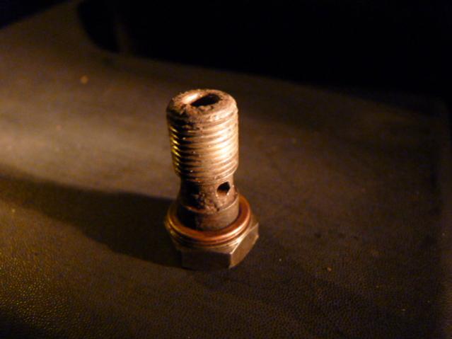

Also, check you breather line. See attached. It terminates in a banjo bolt, the bolt is hollow, it and/or the line gets plugged with mud, and oil fumes build up pressure and leak through seals. Also does this on the axles. Pix of gunked up bolt that was cleaned out.
