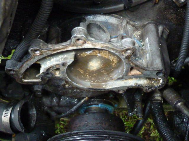

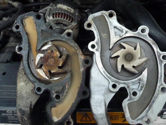

Will look like this, D1 = D2 water pump. When they get high miles, the pump wobbles and leaks. Wobble = eat aluminum. Fan comes off by restricting movement of fan belt, wrench on fan bolt of the water pump, and hit wrench hard and sharp, toward the passenger side (on a NAS vehicle).
