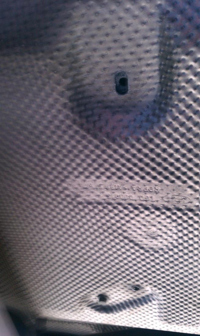

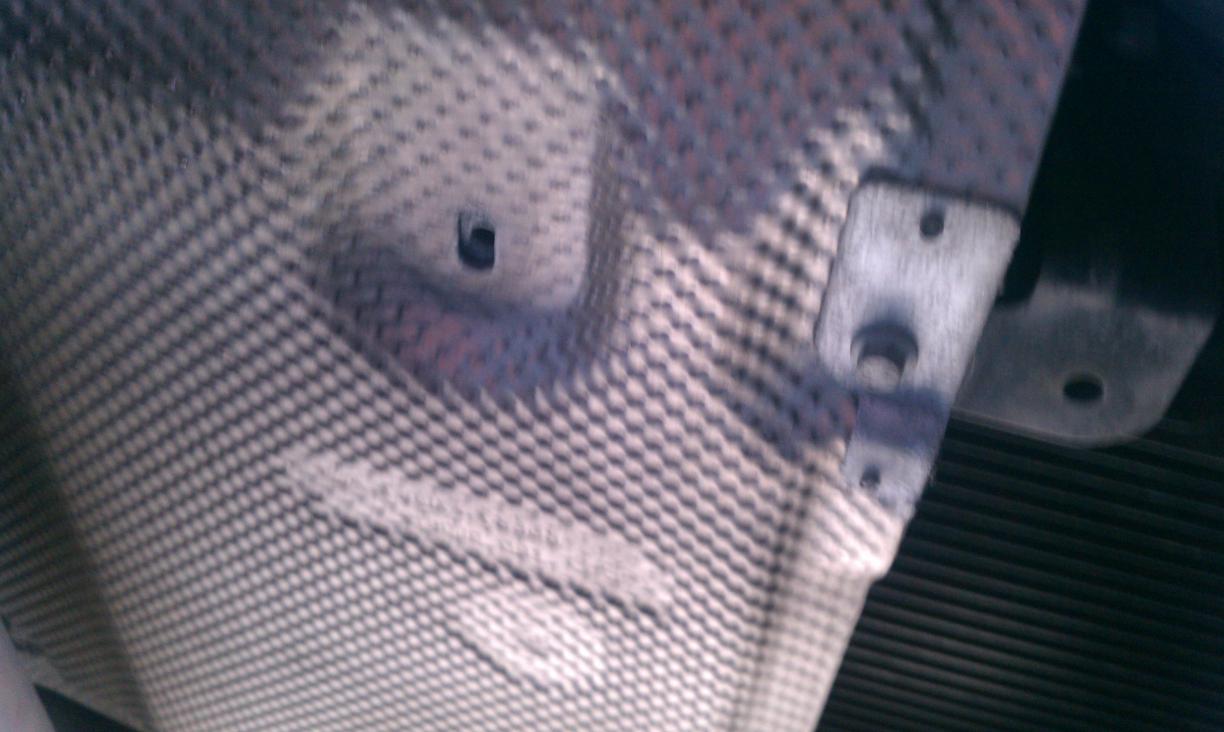

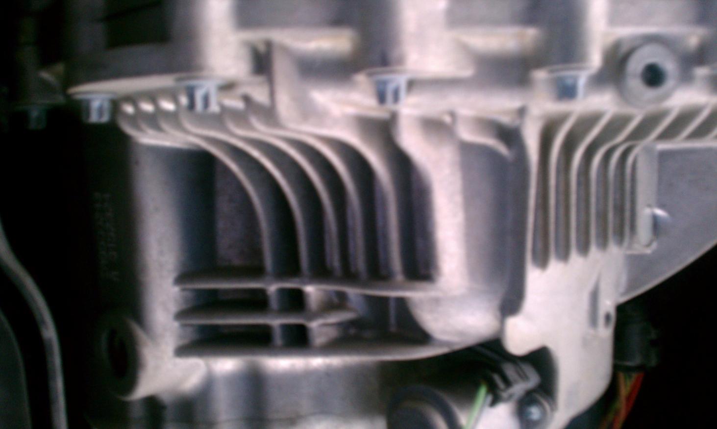

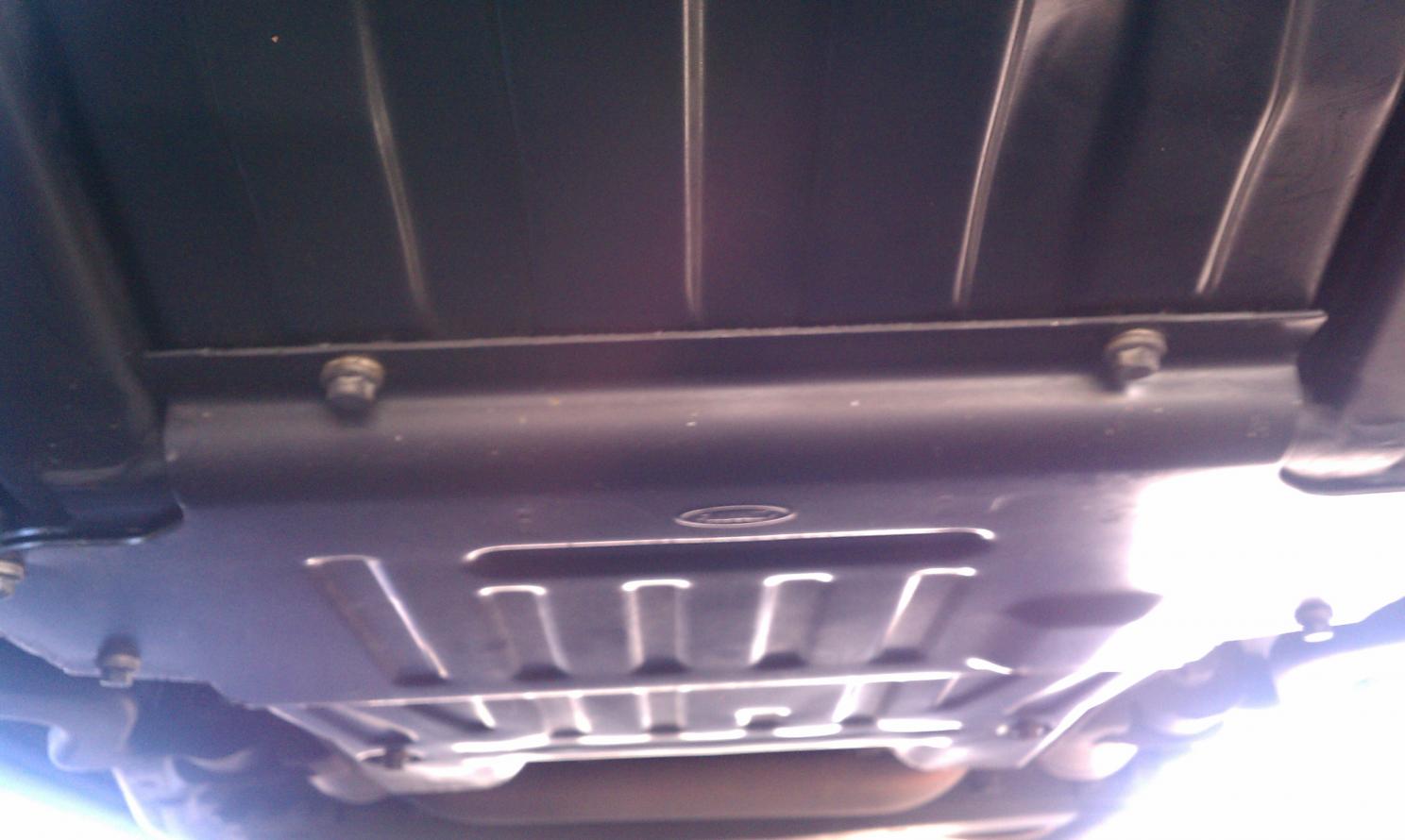

Hopefully I've uploaded these pics correctly. There are two bolts missing and a cover over most of the engine. No fluid anywhere.

Would call installing dealer and ask how they want to handle it. Would not drive around looking for a shop. If you have to deal with a local shop, ask if they have a contract wrecker, and if their electronic shop data manuals cover that year Land Rover. Based on grinding noises, most likely will need differential gears replaced. If mechanic wants you to just to flush metal parts out and refill with heavier oil you might be able to do a test drive. But driving home???
Also, pay with credit card, if possible, so you have 60 days to dispute if this repair does not work.
