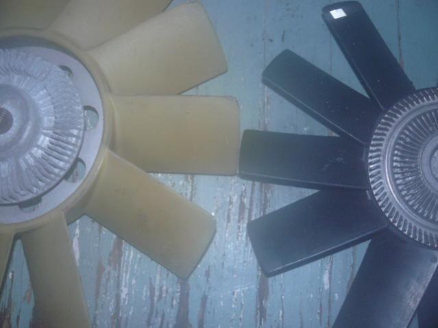

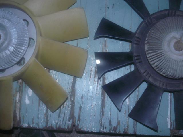

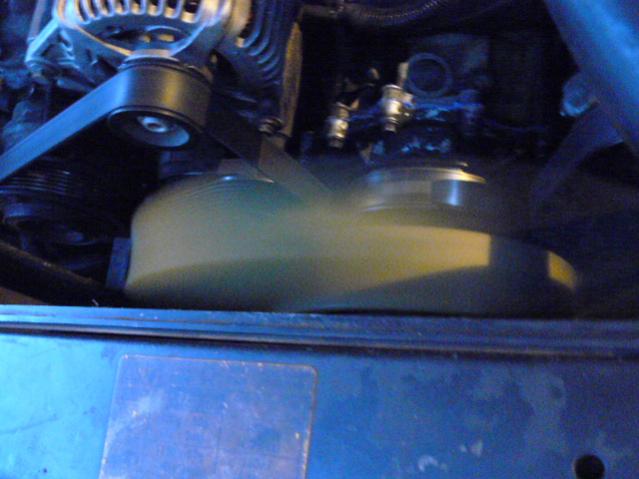

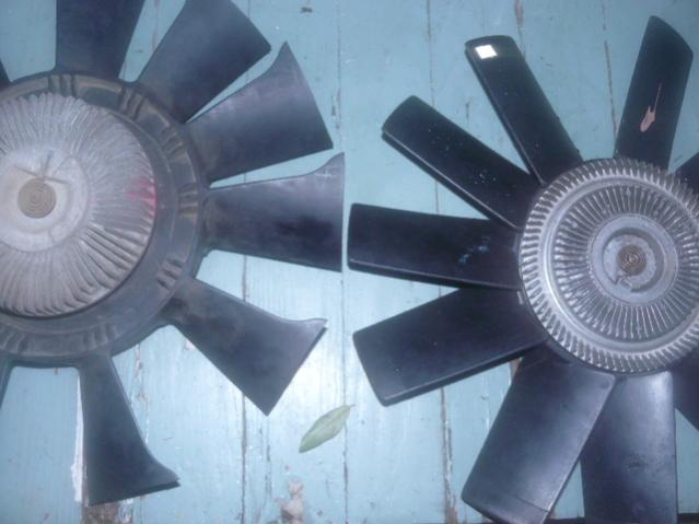

2001 Chevy Blazer to Rover D1 (maybe D2 and others) fan clutch conversion -
Late 90's to early 2000's Chevy/GMC just happen to use a six inch size reverse direction fan clutch with same mounting thread as the Discovery water pump. Bolt pattern for fan is usable with stock fan if you drill out to enlarge the fan mounting holes slightly.
So you can use a junkyard fan clutch, even if no Rovers in your junkyard. About $10. $6 more for the fan.
But what about a bigger fan? I found one on a 98 GMC pickup, scribed and cut it down with snips to fit the Disco fan shroud, moved about 40% more air than stock.
Found a fan with larger blades on a 2001 Blazer, cut it down (both GMC and Blazer fans made out of nylon), and it moves about 10% more air than the GMC. A little noiser, you can hear it slightly when you are driving.
Have not run final mpg figures. Last fan lets my truck idle with AC on at 192F, before I was 207F. I'm running a 180 stat, scanner says 172 - 174 with no AC at 55 mph, 176-178 with AC.
Pix of comparisons to stock, the GMC pickup fan (black) and the Blazer fan (tan).
Just proves that you can fool around with fans and clutches on a budget, for testing or empty pockets repairs. Or repairs when you are a long way from a Rover clutch.
