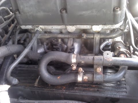

Here's how most of the heater cores are done in PR - submitted by our man slanginsanjuan. Of course, it "disco-nnects" the built in "water fall sound" alarm for leaky head gaskets...
