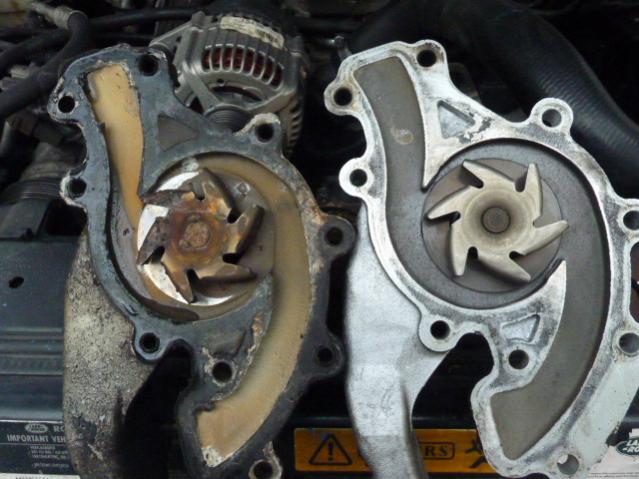

1. Read up on it in the RAVE. Have to get that pulley off, 185 foot pounds, several techniques.
2. You'll do front crank oil seal by default.
3. New water pump, new oil pump (more than several failures and cracked pumps reported), timing chain. Might need new fan clutch, does it free wheel when warmed up?
4. Read recent posts on front cover, several have just posted comments and fresh pix. One in particular about what was thought to be a hairline crack in cover, but turned out to be a line from the factory process..
5. Get rid of dex cool. Makes mud. Don't put in coolant system stopz leekz.

Dex Cool is bad for anything, because users are sold on it being a long life coolant. So they leave it in. And along the way, maybe it gets topped up with other formula coolant. The result either way is sludge. If you never change coolant you'll get some sludge as well, it just won't be as orange colored. Just Google "dex cool sludge", or look on Google images for same. You'll also find posts on other sites of people who change Dex Cool frequently and have no problems.
Use commercial (not home brew) radiator flush, keep flushing until water comes out clear, may take several tries. Refill with green or yellow coolant and distilled water. Brands include Peak.

Since your dexcool pictures scared the hell out of me, I decided to get the engine scope out and look in various cracks and crevices for built up dexcool, or any other issues. I didnt find a thing wrong with the radiator or any other parts I looked into...the radiator was spotless inside...as was the water pump.
