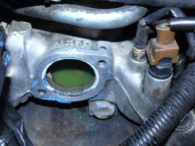

I believe your friend was talking about the coolant temp sensor. There are two vertical sensors to the side of the thermostat. The one with a single wire drives the heat gauge. The one with a square top and two wires drives the ECU. If it is unplugged, it makes the engine think it is -40F and you need more fuel. These are in the top right pix attached.
Here is pix of where the other one is. It is X128 in the bottom left pix. It measures engine fuel temp, and is normally associated with problems dealing with hot starts. It basically tells the ECU to run a little more fuelto get the vapor lock bubbles out of the injection system. I would suppose if it is wierd this time of year (cold in North America) that it could do other things.
Also attached is color pix of both gauge and coolant temp sensors, coolant on right.
From the RAVE:

I know that on my cheap scanner the coolant temp shows up as a reading, but fuel temp does not. This is not the same as the temp gauge, which uses another sensor. If you don't have a scanner, your local parts store could read it for you. A sensible coolant temp sensor reading (like 195 - 208F) in their parking lot may point toward the fuel temp sensor. Unplug the coolant temp sensor and the heat gauge won't change but the scanner will show something like -40F. A bad coolant sensor usually makes other things show up, like running rich, high idle. But the RAVE says hot start problems could also be this.
