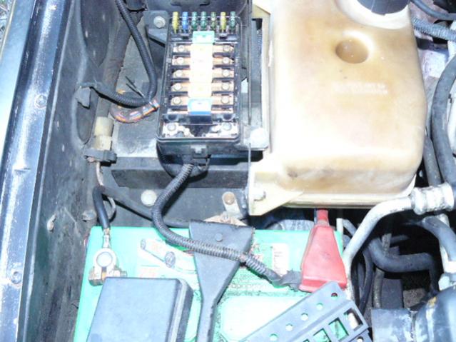

Belt route is very important. Other little things include terminals clean enough to kiss, including ones on top of battery and the two large ones inside the underhood fuse box. You clean terminals WITH THE BATTERY DISCONNECTED.
But since you could crank the truck and drive around, you might also have a new problem, a drain in the electrical system that kills the battery after you power off the truck.
A great tool is a $10 - 20 voltmeter from Wal AMrt, Harbor freight, etc. If battery is being charged, volts across it will be 13.8 - 14.2 volts. One easy way to test with a meter is to measure battery with truck turned off. Let's say that is 12.9 volts. Don't crank truck, but turn on head lights. Volts should not drop below 11.5 - 12 volts. If you have a "dead cell" in a battery, the volts will drop like a stone under load. Then crank truck. Volts should come up to 13.4 - 13.6 with lights on, or a little higher. That proves alternator can charge the battery while also running a load (lights and rest of truck).
It is possible to have a fairly new battery that is defective and has a "dead cell". It is also possible to have something in the truck drawing current after the key is off, and run the battery down. This can cause real issues with the alarm system, which thinks Fortress Rover is under assult, and immobilizes the starter system....
Hoping you just have a belt issue, or left on some lights. If you park inside a garage or protected area, might consider leaving alarm off, and disconnect battery tonight to be sure you have a battery in the morning to get to work.

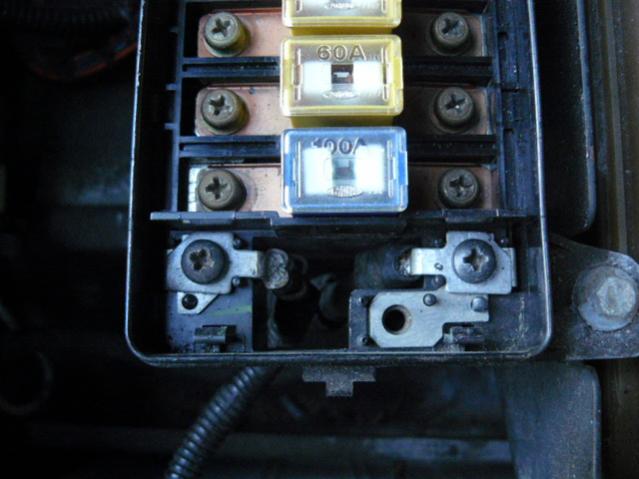

Your battery has a dead cell, so it can't hold up voltage under a good load. It will read normal charge volts, those electrons come from the alternator.
With truck OFF, read volts across battery. Then switch on head lights. Voltage should not drop by more than 0.5 volts or so. Head lights should not be way too dim. A battery with a dead cell will drop voltage quickly under load, head lights will be barely on, etc. Crank truck. Voltage should increase across battery as alternator charges up battery and keep up with the load.
Or you could have dirty terminals on the battery or the main fuse box. See big ones at front of fuse box. All terminal posts and conectors on them should be so clean you can kiss them. Don't wanna pucker up? Then keep cleanin'!
