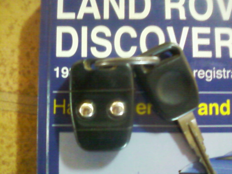

My Disco 1 's key thomb went hay wire.
It seems that the lock button was stuck down and depleted the battery in the unit. getting the car with key symbol on the dash board.
Is there a way by passing this phenomena.
I'm stuck at the farm and nearest town 80km away.

Thank you so much for all the info on this matter.
I am so chuffed with myself due to the fact that the Disco came to life this afternoon.
Problem: the key fob was ooo.
Because I am quite in the bush innovation was the answer.
The old pentium 2 computer 16x Cd drive's micro switch came in usefull.
Armed with headlamp and magnifying glass I took the Cd drive micro switch's tinni winni conecting plate (1mm circle) out and was a perfect fit in the key fob's micro switch. A few buttons (Hole plugs) and little bit of Q-Bond and WALLA the doors unlock and the dreadfull key icon was gone from the dash board.
The Disco roared on the touch of the key and I am smiling ear to ear.
