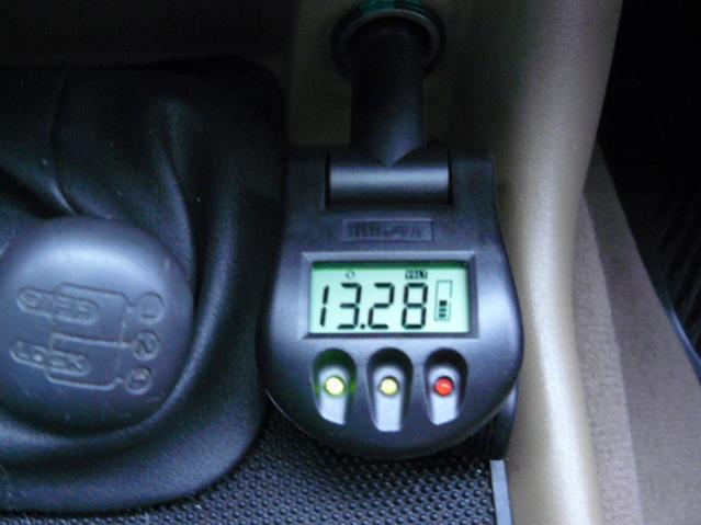

Many owners on this forum have chased electrical gremlins in several versions of Rovers that were designed by electrical engineers run wild. The level of electronics demands a very reliable and stable power supply. That would be your battery, and unlike the old Chevy pickup that might be able to use the same battery for five years or more, you'll be lucky to get three. You can also monitor your electrical system voltage from the cigar lighter, with a $20 plug in meter from Wal Mart. Normal voltage should be in the 13.8 - 14.2 range, but what you may notice is a change in voltage when you are having other glitches. Might be an early warning for an alternator going out. Reading on this meter is a D1 at idle, with lights, AC, radio, wipers, etc. all turned on. If an alternator has a failed regulator it usually won't have any output, if a diode blows, the output amps could be reduced by 33%, so truck would do OK, except whe you try to use lots of devices (raining at night with AC, wipers, high beams on).
Also, you can buy an advanced scanner like the Hawkeye and diagnose a lot of electrical problems yourself. About 5 hours of shop time....

Can also be related to corrosion on battery terminals and cables, large cables and fuse links in any underhood fuse box, and the spot where the (-) battery cable is bolted to the frame. Your vehicle has more computing power than the Manhattan project.
