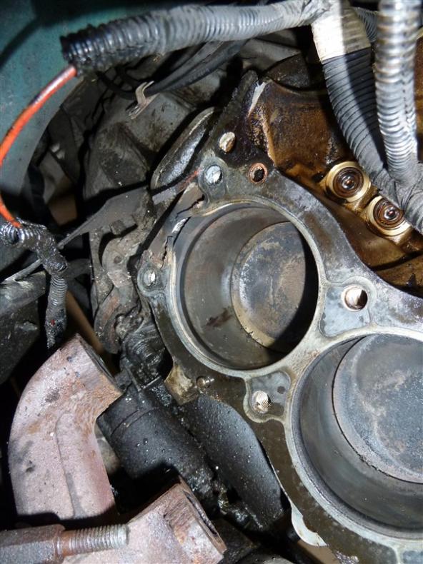

May need a third opinion. See pix of failed HG. The "slot" is the water channel, front and rear of each side of engine. Very common for HG to fail at front or rear cylinders, because the coolant channel is right next to them. The number of bad HG is much much higher than cracked blocks, at least reported on this forum.
A coolant pressure test can detect a leak, but only at 20 PSI or less, as that is the pressure rating for various parts of the cooling system, hose start to pop off, etc. A block pressure test removes the cooling components from the loop, and goes up to say 80 PSI, and looks for pin holes, etc. So while a coolant test may find a really big cracked block, it might not find the smaller ones. A cracked block usually causes overheating spikes as steam is injected into the cooling system, violent bubbles in the coolant reserve tank, hoses hard as a rock, etc. And it certainly may have a slipped sleeve tick involved.
Won't be able to "see" the crack behind a sleeve in the block, will have to infer that from coolant at the top of the sleeve.
You can put a dye in the coolant and it will show up in the cylinders and on the spark plugs. It is a bigger problem if it shows up on the in-board cylinders.
DIY HG is quite possible, reported on here weekly it seems, $300 parts and new bolts, $200 machine shop to flatten heads and test them. A used head, should you have a cracked one, is like $90.
Indy shop HG are in the $1500 - $1700 range.
