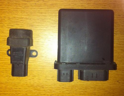

Can anyone send me pics of the inertia switch, and fuel pump relay? I just purchased this 98 and it wont start. I do NOT have any pressure on the fuel rail. I cant hear the pump running in the tank . So I did a quick search on here and found to check these things first. The Rover has 121K on the clock. Thanks in advance.

The inerita switch is right on the fire wall next to the 2 heater hoses, the relay is over between the battery and coolant bottle.

The unit on the left is the inertia switch and the relay module is on the right. Mike told you where they were located in the engine bay. Should you find you need one, I have plenty of good ones used.
