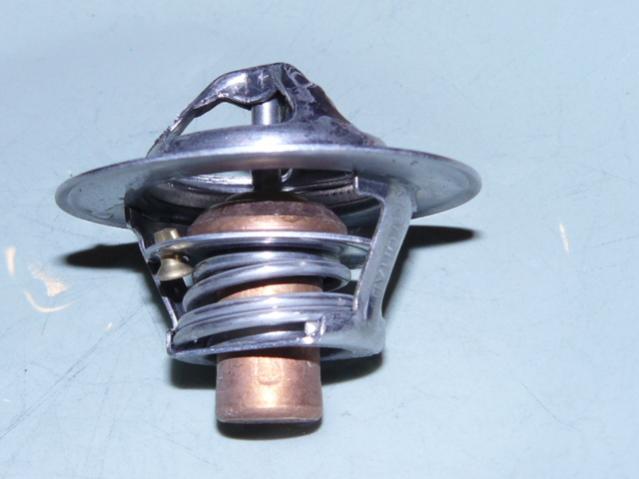

Pix 1 - basic set up, with container selection by SHMBO.

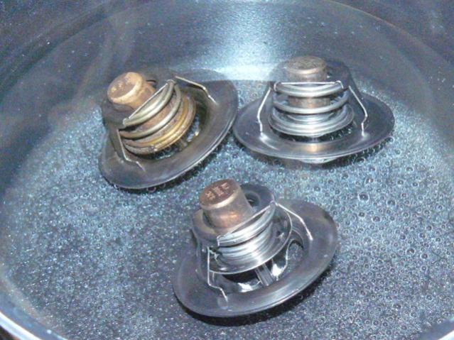

Pix 2 - two upper stats are 195 F, note that left one has opened up faster than right one. Lower stat is a 180 F for comparison.

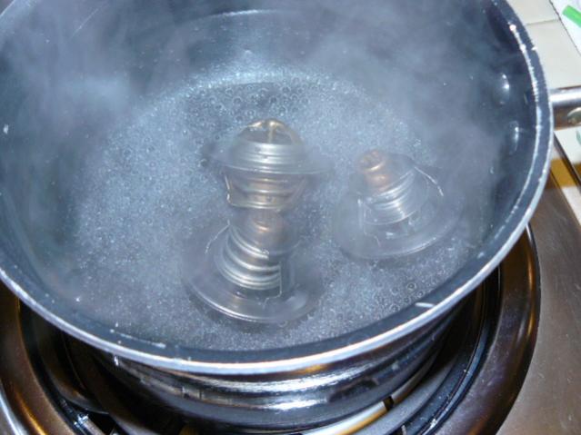

Pix 3 - fully open stat - note position of disc
So if you have a box full of same temp rated stats, some will be high, some low, and some on the money.

Are the 195's from the same MFG?

All three from the "MotoRad" factory.
