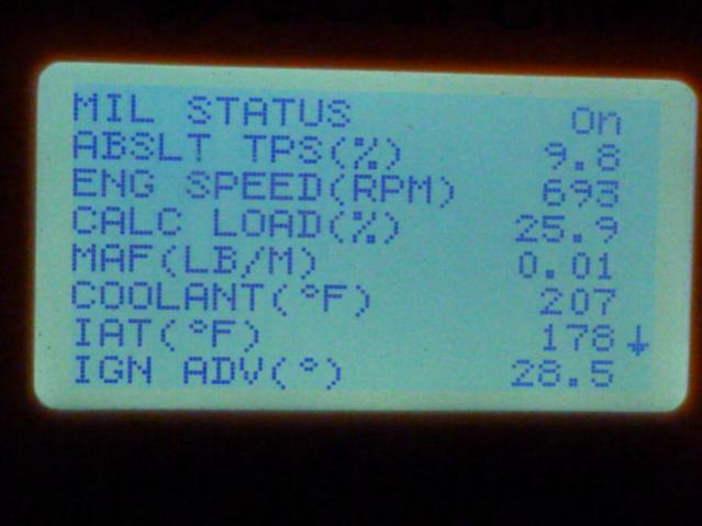

1. Go by Walmart, and buy a less than $20 plug in battery tester. Plugs in lighter. See Plug In Electrical System Tester Pix. This will allow you to monitor electrical system, and when problem happens you can write down the voltage. Should be 13.8 - 14.2 when running with no AC on. Usually the battery light being on is a bad sign.
2. Loud engine noise might be electric fan that provides boost cooling for AC and overheated engine coming on. You could plug in a scanner or an Ultra Gauge, and see what coolant temperature was present when this is happening. Many vehicles, including Rovers, use the electronic engine coolant sensor to tell the engine computer the interior water temp, and the computer and other modules perform all sorts of tricks based on that data. If the sensor is bad, or the wiring conector is trashed, you can get bogus readings and results. As an example, if your scanner showed engine temp of 200 degrees, and suddenly went to 250 or -40, the engine computer would make adjustments, even though it is not logical for such a rapid change to happen.
