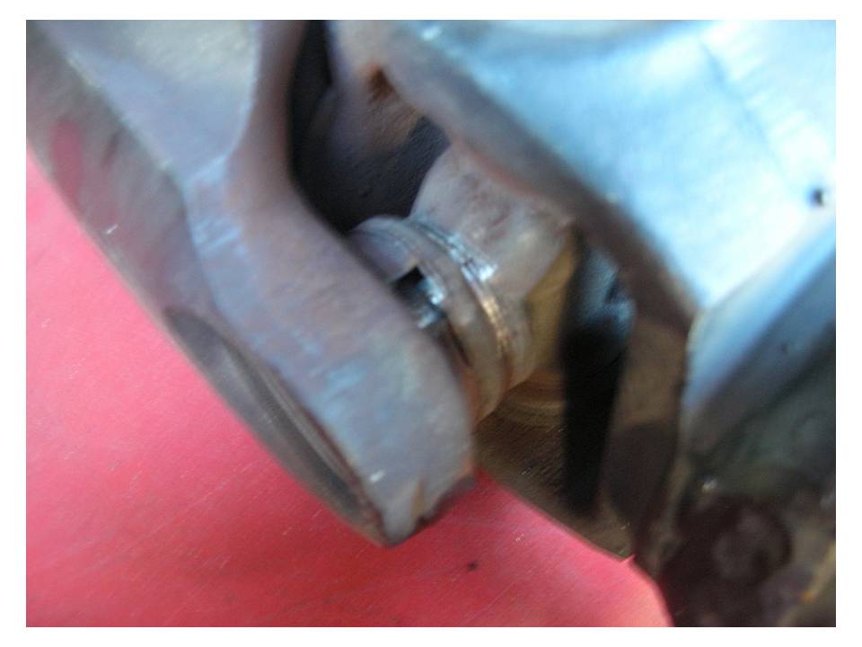

I beg to differ. The water from the condensation does damage the joint. I have seen a LOT of these joints and I have spoken to a couple of differential shops which more or less looked at it and confirmed with a "definitely". Most of the joints have a rust spot because of the constant raining down of the condensation. I've been through a dozen discovery 2's and they all had the rust spot. In my experience its always the u-joint that is being rained on that goes bad. I've been through a lot of these cars man. Notice the reddish hue next to the bad u-joint. Haven't you ever heard of Chinese torture? A drip doesn't seem like a bad thing. What can it hurt? But let a drip hit a mans forehead over and over again and eventually water will come out his ears! Here's the bad joint and the noticeable rust:

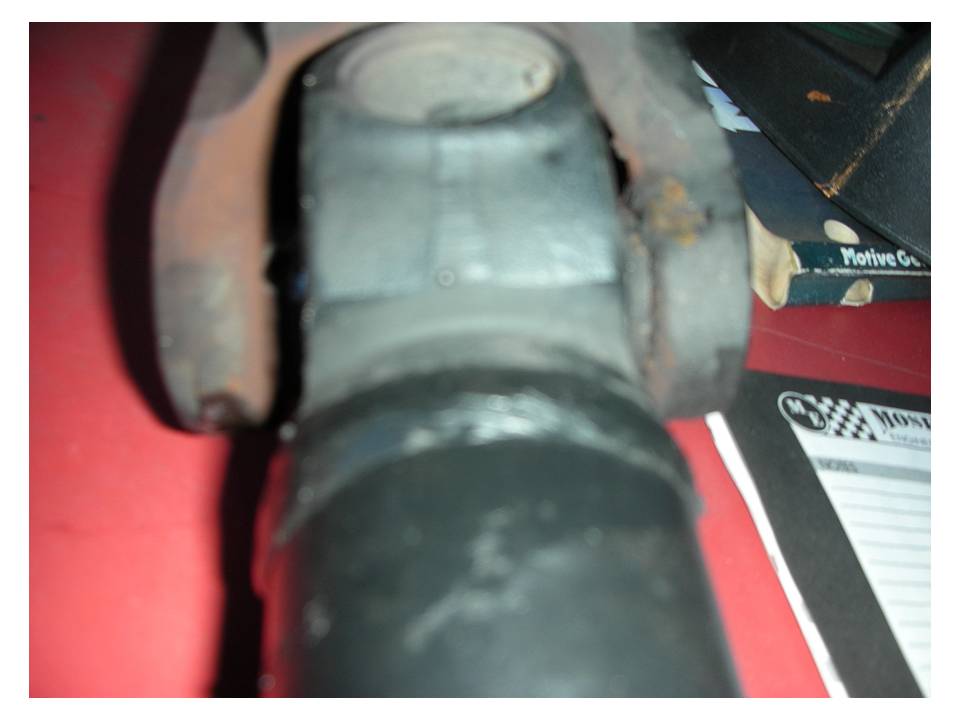

Here's another shot of a shaft with evidence of rust. Both pictures ive posted from my own discovery 2 that i took into a diff shop to install my loop. The car was driving like a dream. I had no idea the shaft was bad. When he took the shaft out it was bad (the first photo i posted shows the condition of the joint). 2 weeks prior to this removal i discussed the idea of the loop with my regular mechanic. He's a regular mechanic, not a land rover one, but he's nothing short of brilliant. He looked at the shaft while it was still in the vehicle and said "its fine, i wouldn't worry about it so much". It is really really hard to tell if your joints are going bad unless you physically remove it from the vehicle. The diff shop wanted to sell me an $800.00 after market shaft and actually told me you can't rebuild them! (part of the reason why i'm not into the aftermarket stuff!) I was polite and had it rebuilt elsewhere for 200.00 and haven't had a problem since. That was 18 months ago. Here's the pic:

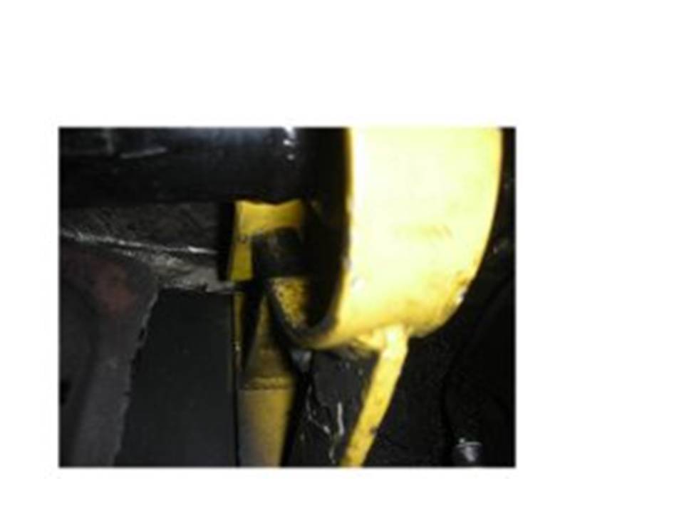

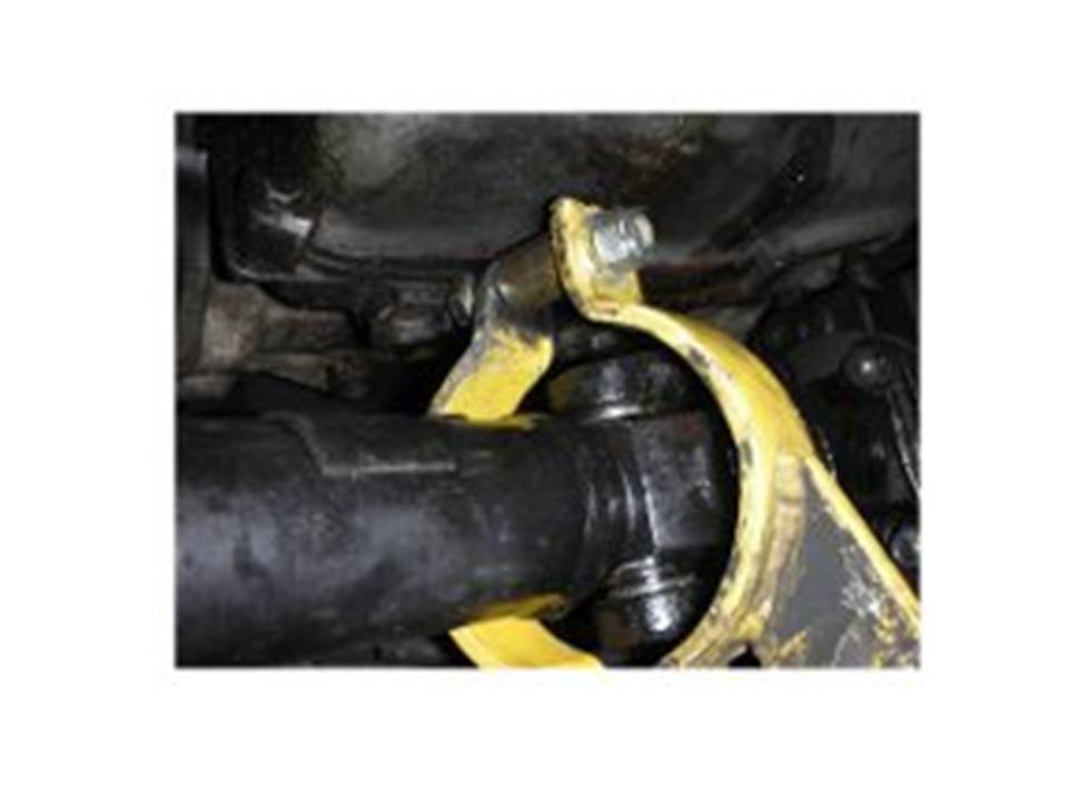

okay, it's Saturday and I didn't want to do this, but I went under my discovery 2 to take pictures of the loop. This is the prototype installed, and has been for 18 months. The difference in this loop to the new one that you will receive is that there is no lip that LOOKS dangerously close to the tranny (though it is not). Its never touched the tranny and i've even carried 40, 60 pound bags of concrete in the back and i've never had a problem with it touching the tranny. But rest assured, the new model doesn't even have this lip, and i've designed it without compromising the strength or integrity of the loop. Also, this one bolted to the frame with 1/2 inch bolts, the one you will be receiving mounts with 1/4 inch self tapping screws with an idiot proof bracket. As I've stated, if you know your way around a car, you can have this installed in 15 minutes. If you are interested buy it from ebay and send it back if you're not happy. Its through paypal so you're money is insured, but I will be delighted to give you your money back if you are not satisfied.
If you don't want to buy it from me then I suggest building one yourself because this rids your rover of its "Achilles heal". But why build it yourself when i'm selling it so cheap!

looks like i can only post one pic per message....
Here:
