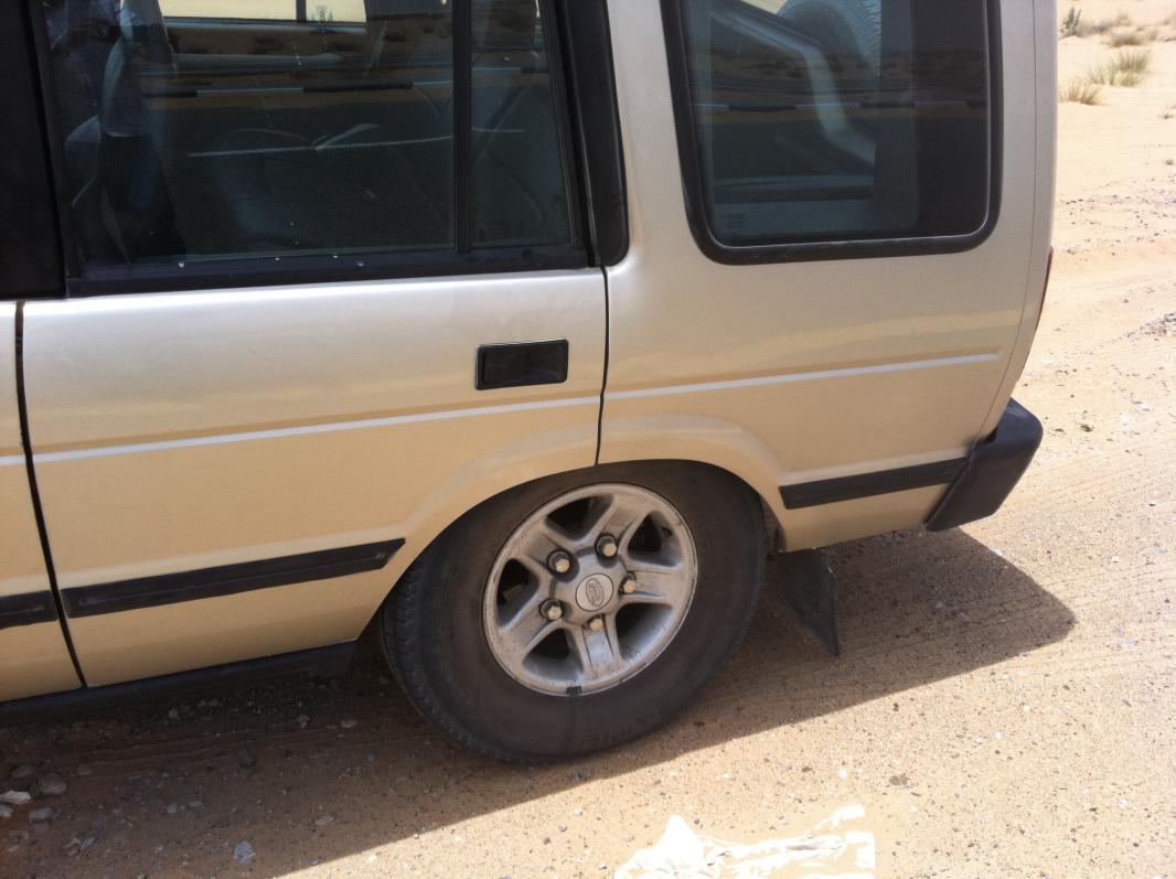

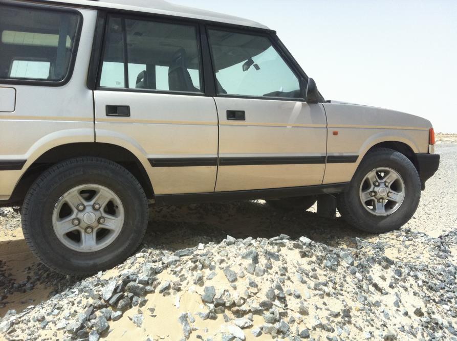

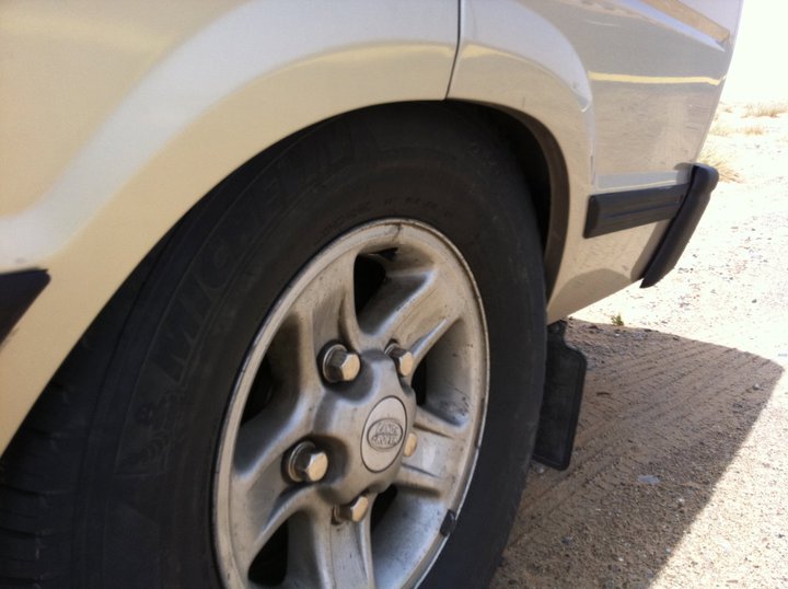

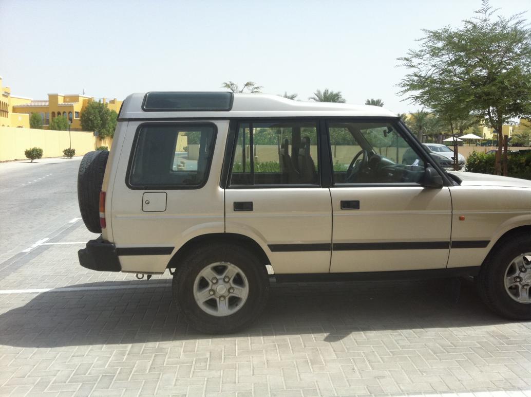

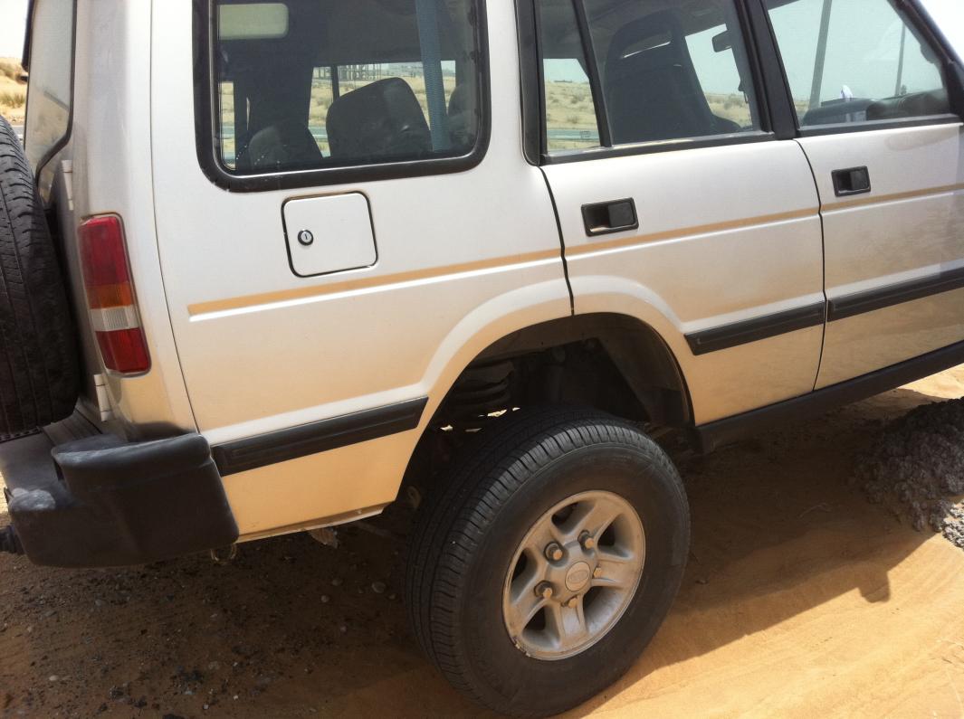

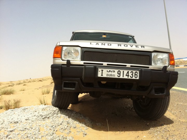

Thank you all for your contribution. I promised to put up some latest photos and here it is . Do you think putting up a Skid Plate or mount an Bull Bar is recommended?Mainly I will be driving in Desert (Sand Dune Bashing) sometimes might counter some rocks. Does it give my ride a nicer and sharper look?
Regards.

No, do not add a skid plate, you dont need it and it is just going to restrict air flow to the engine and make her run hotter.
The winch bumper would look cool and would be a nice addition.
