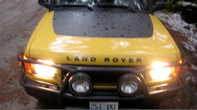

Here's some cheap cosmetic mods - Just need some rattle cans, some painter's tape and some time.
1. Hood Blackout (see pic) - just need paint, tape and newspaper (or buy the decal online)
2. Freshen up Fender Flares/Bumper Corners/Trim - use Krylon Fusion for Plastics
3. Paint Wheels? This would be a good option if your wheels are scuffed up or the finish is fading due to corrosion caused by brake dust...I have this problem thanks to the PO.
.....Simple green and a rag will take care of any over-spray.
Disco's have the option of dual sunroofs or none, so you're setup must be aftermarket. I think the headliner in either trim level is the same, they just cut out the extra headliner when they put in the sunroofs.

These are all great ideas. I used Mother's Back to Black last weekend, and the parts that weren't scuffed came out great, but the parts that were stand out even worse. I think I'm going to remove all of them, sand them down, and use the paint you suggested. Would you suggest a specific type for the hood? Also, did you paint your LAND ROVER black as well or did it come that way? Mine's silver. I think I'm also going to end up clay barring it as well. Give it a nice detail for once.

For the hood I would suggest any sort of outdoor/auto paint in flat black. Either way I'd scuff it up a bit with a sanding block, prime it, and use flat black. I used Duplicolor Sand-able primer to "repaint" my old Land Cruiser and it went on smooth, has been very durable and is really easy to touch up.
Yes, my LR emblems came black from the factory.
