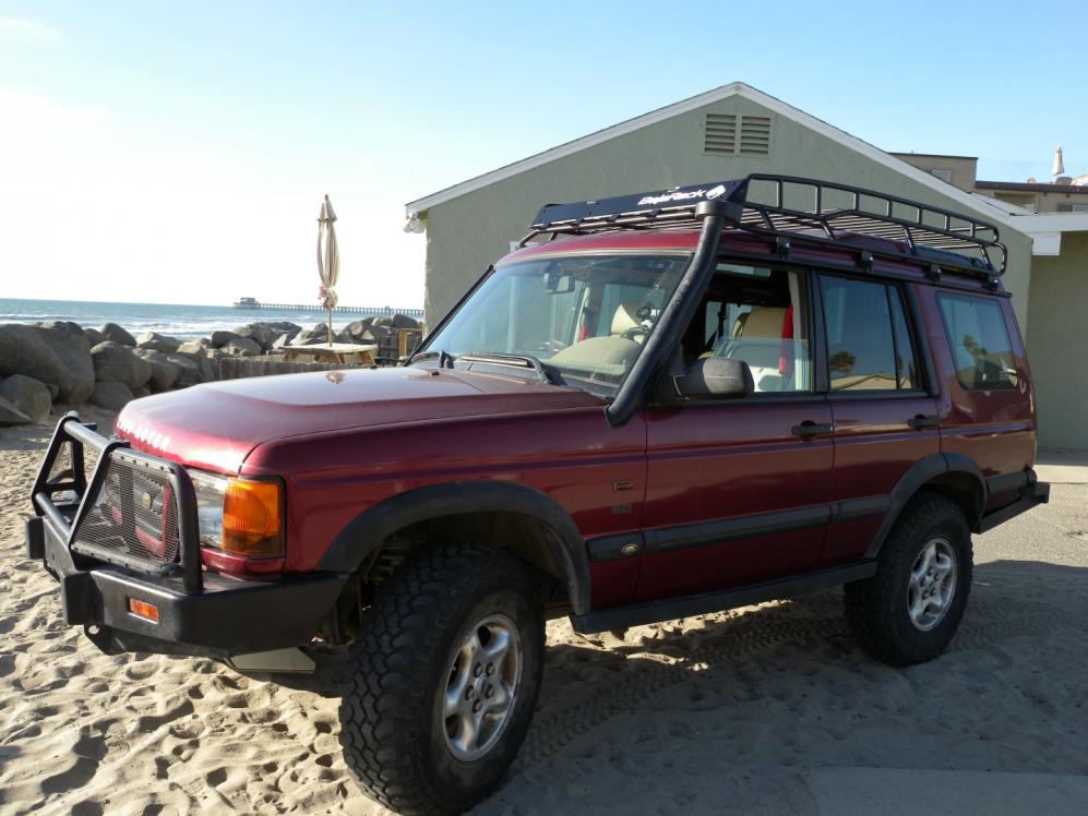

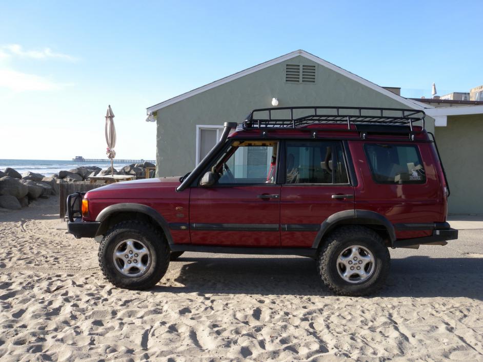

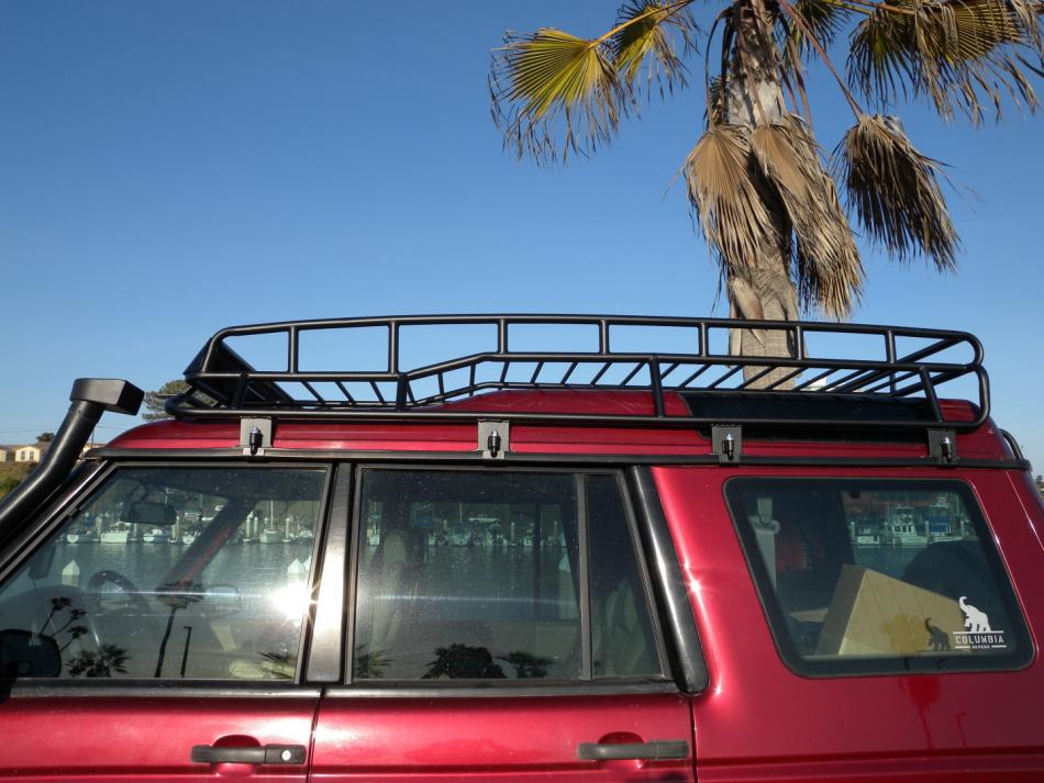

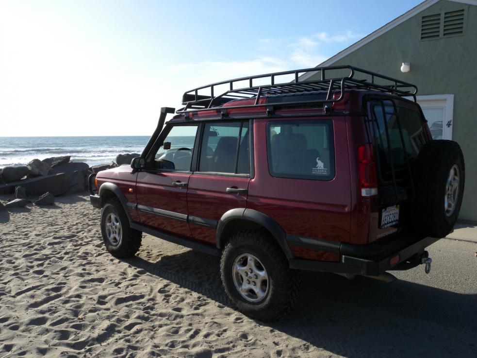

Another option for a split-level roof rack is BajaRack, They make roof racks for D1, D2, RRC and LR3. They offer both low and high profile roof racks for the Discos. BajaRack just came out with their Land Rover line so you won't find them on their website, http://www.bajarack.com
I purchased one of the low-profile D2 racks last week. It weighs about 70 lbs yet is quite stout. I weigh around 200 lbs and when I stand on top, I don't notice any flexing in the rack.
You might want to Google and check on the history of Rover Racks and NWP. As for the SD rack, some think it's the definitive rack for Discos. However I know of several that cracked so I looked elsewhere and found BajaRack. The link below shows two (2) SD racks that cracked.
http://www2.expeditionexchange.com/f...ght=difference
I've attached some pictures of BajaRack's low-profile D2 rack.
