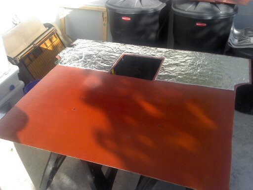

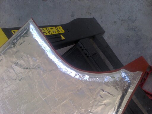

i used an 1/4 inch insulation i bought on ebay between the old and new floors. I noticed an immediate benefit in heat and noise. i'll add more behind the headliner and probably the hood.
i think it would definitely help although you would need to do it extensively.

What is that insulation made of? If it's the same type I've seen (foam or fiber based), it's only marginally effective for noise compared to properly applied acoustical products.

Quote:
yes fiber and foil.
well according to the manufacturer it's awesome.
i don't think so...but i do think it helps and has quieted down the truck as I removed all the padding and carpets.
i know it has reduced heat.
i also know you're a pro and there are going to be lots of better products and procedures. For the costs and requirement, it worked just fine.

Not meaning to be critical, I was just curious if it was a different material from the one I mentioned. If you're first priority is heat retention or rejection and you accept the slight noise reduction characteristics as a minimal side effect than yeah it's great. I simply wanted to point out that according to the conventional math, 1/4" of anything porous (foam, fiber, etc.) is far too thin for absorption within the audible range. I have successfully used 1/4" foam before to stop panel squeaks and vibrations.
