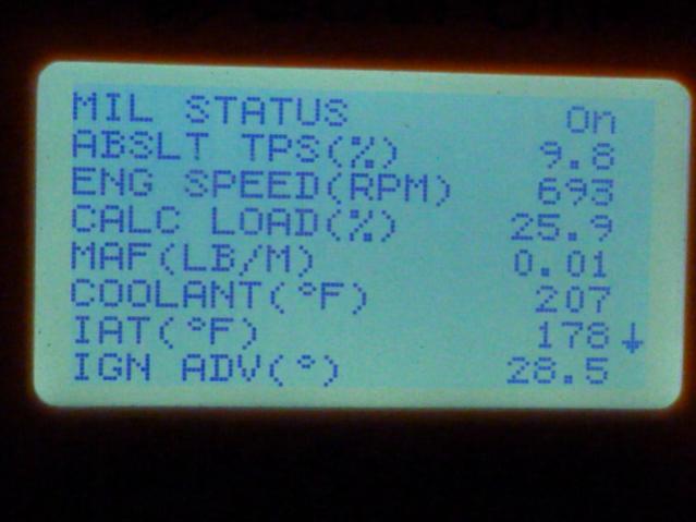

6. After I worked on all that, mine will idle and temp guage stays about 8:00 psoition. Over 9:00 is too warm. A scanner that can read live data will show you how bad things are getting.

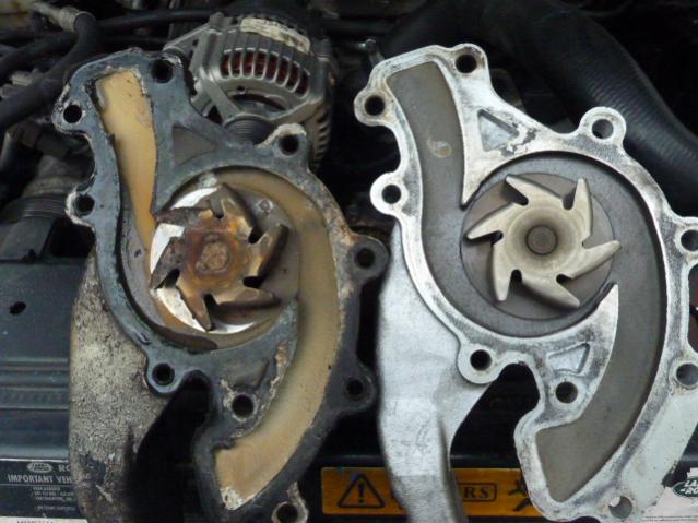

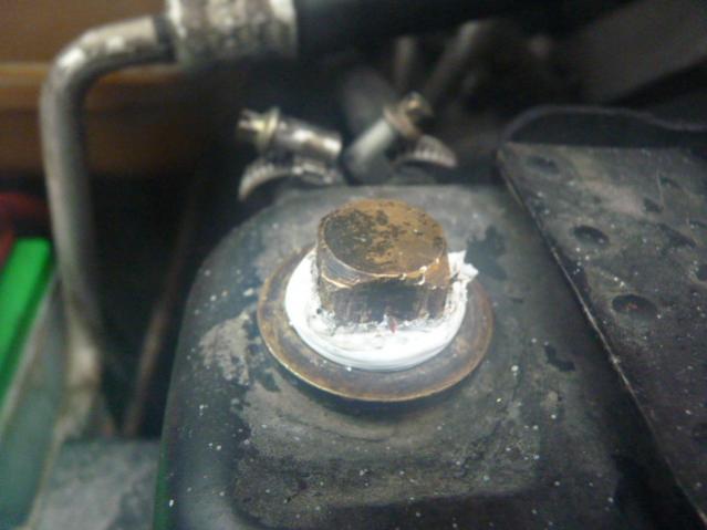

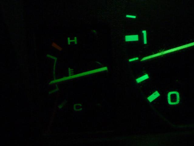

Note: Pix show normal temp guage reading, but it should be 195 temp, I was at 207, imagine what yours was at the top of the guage. Also shows what to expect from a water pump that is wobbly or grinding, note coating from use of "stoppz leekz", and the replacement fill plug.
