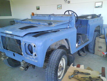

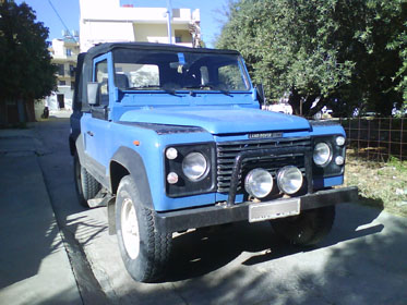

Posts: 6
There you go During renovation and after

Old 05-26-2010, 12:29 PM
yloDiscoII's Avatar
Senior Member
Join Date: Nov 2009
Location: South King Co, WA
Posts: 2,334
Thumbs up
THAT THING IS AWESOME, thanks for sharing. Hope everything works out and gets resolved!
