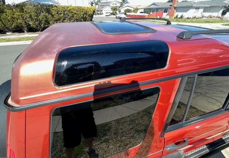

So as I thought about it more after we chatted, I think it is possible this is the alpine windows with what I saw around them. Sorry, you caught me when i still had desert on the brain and didn’t recall the state of those.
And as I have a few moments to think clearly, I’d say- regardless of rain- priority needs to be to pull the headliner and inspect. I know we talked about the drains, but if I’m thinking correctly, and looking at the headliner, it could very well be coming from there.
Now, to keep from diving headlong into the whole headliner dance (not just pulling it, but recovering and blah blah blah) perhaps just get to where you clean the drains and go from there, but I’m thinking more this is the alpine windows.

Thanks. I'll run a bead of silicone around them tonight (assuming this damn rain stops). My goal is to flush the coolant this Saturday at which point she should be mechanically sound and able to move under her own power. We're going to get a quote to fix the rust round the alpine window and paint the roof and hood (and remove the cracking clear bra). Given then leaks, this will take priority over the lift and tires. But those will be next. And fixing up the special project which you know about. At least that will be a fun project.

The problem I have for the roof is that there is rust around the passenger side alpine window which needs to be repaired. If you zoom in on the picture you can see it. I think it's bad enough that it's causing leaks. The drivers side alpine window has what appears to be surface rust, but may be a little deeper too. Repairing rust is not in my wheelhouse so it'll need to be done by a pro. On the hood, many many years ago one of the prior owners installed a clear bra on the front edge of the hood and it is going to be a bitch to remove and the clear coat is flaking. If it was just spraying, I'd be inclined to do it myself, especially on the roof where people won't really see it.

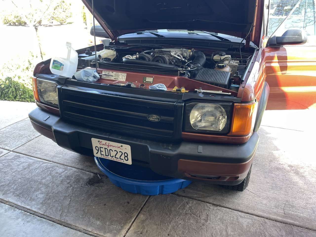

Well today was the big day. Time to flush out the Satan's Nectar (Dexcool), finish up the coolant system, and refill with nice green coolant. It went very smoothly which was a shock. I can usually be counted on for at least one good F-up. (***knocks on wood***)
I flushed it twice using hose water and then twice with distilled water. I did not have the thermostat in and I had the heater turned up full. I would fill it, run it for about a minute, top off the "coolant" while running it, and then shut it down. I drained the "coolant" out by removing the lower right water pump bolt (11mm) and the bottom radiator hose. Putting a worm-drive clamp on the lower hose made removing it much easier.
https://cimg0.ibsrv.net/gimg/landrov...5fc3b6b5cd.jpg
After the fourth flush, I installed the thermostat with the hole up and torqued the water pump bolt to spec. I then installed the Hayden 2991 severe duty clutch fan with the Doorman 620-112 fan. Everything fit perfectly. I know some folks feel the severe duty fan is too loud and sucks too much power from the already anemic engine, we'll see. I live in San Diego where it gets stupid hot during the summers so I'll probably need it. If I decide it's too loud and sucks too much power, I'll swap for the 2781. (My stock fan clutch appears to be shot.)

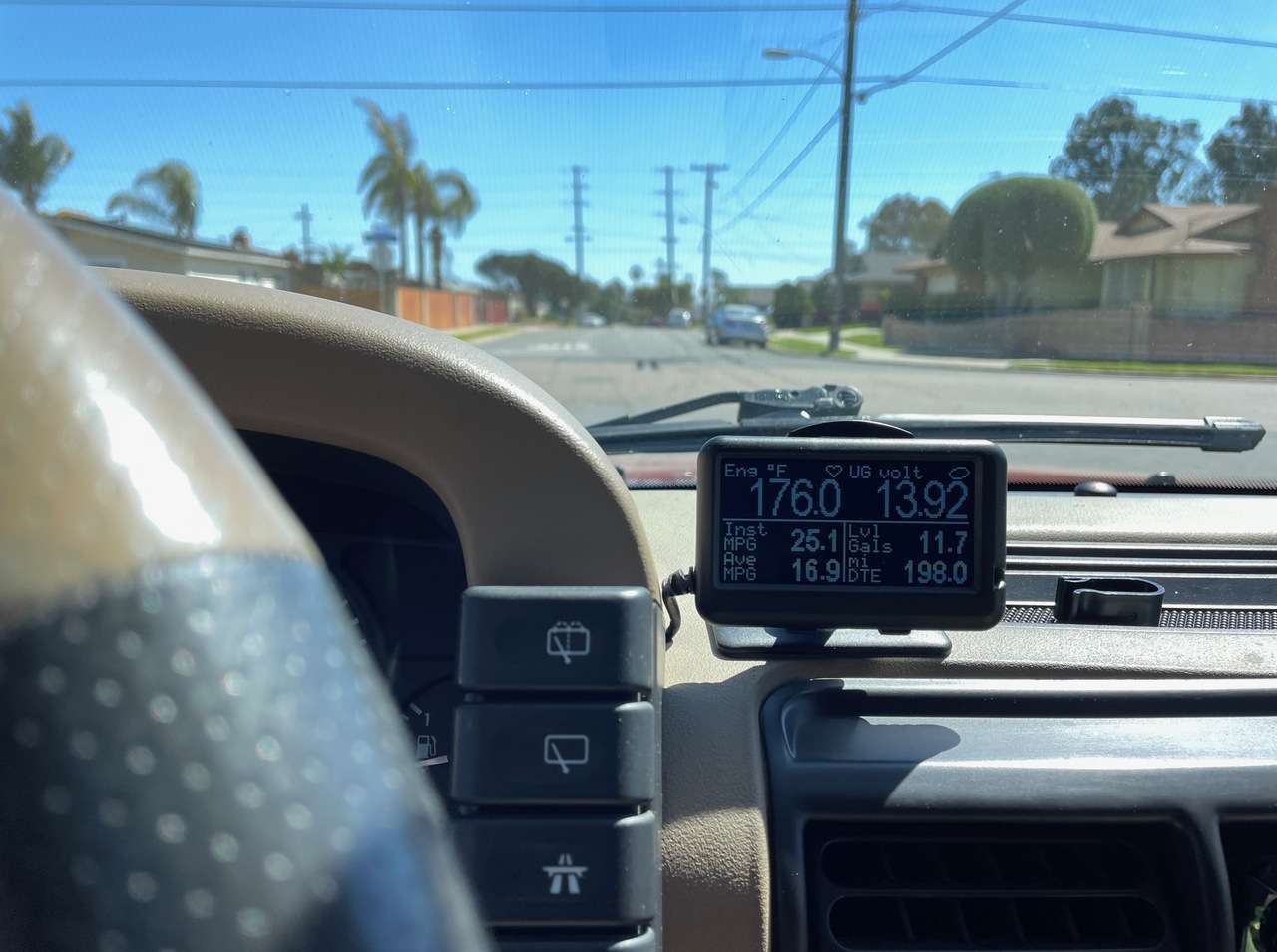

After bleeding it per Extinct's instructions, I took her for a drive. It was weird because I have a small hill I have to drive up to get out of my neighborhood and the temperature quickly went up to 206° so I immediately turned around. It kept climbing and hit 212° as I pulled into my driveway. I figured I must have screwed something up and was about to shut her down when the temps started dropping and eventually came down to 176°. I shrugged, put it in reverse, and went for a drive. (Ambient temp is about 72°) As I drove around the temps would get to about 186-188° and then immediately drop down to 176°. I putted around for about 5 miles, going up and down little hills and it kept doing that, never going above 188° even with stops at stop lights. The only thing I can figure is that the thermostat initially stuck closed and then finally popped loose. Fwiw, I did not notice the fan clutch noise at all and I had the windows down.
