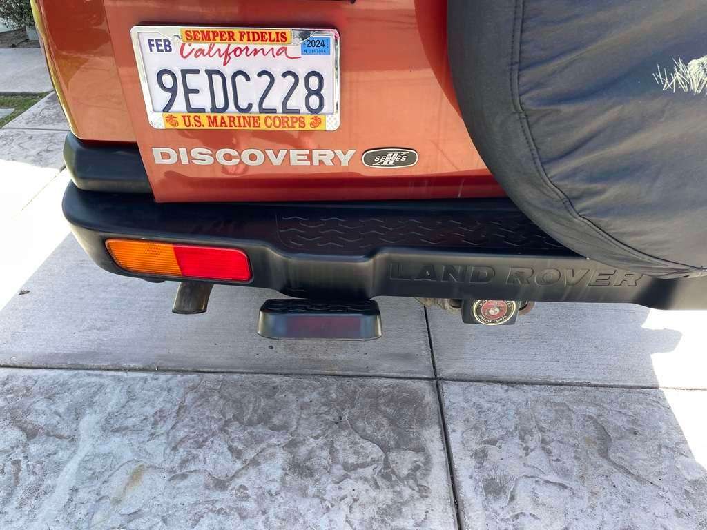

Found an accessory step on eBay for $90 and figured "why not?" Showed up well packaged and in great condition. Mounted up super easily too.

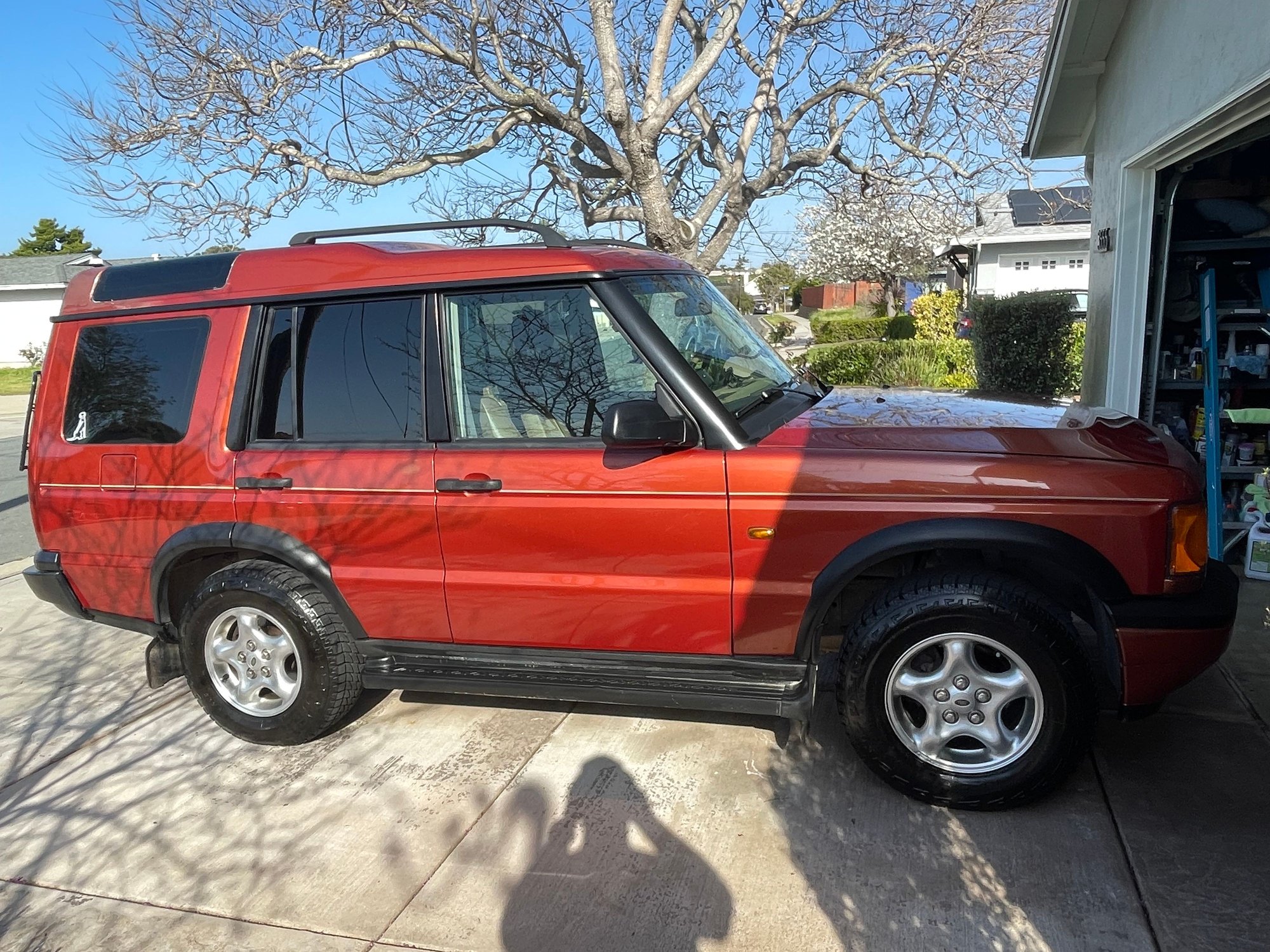

YETIX Apr 15, 2023 08:29 PM
She's running much better with the heavy duty clutch and temps are still perfect, running around 180 to 183 driving around. I gave her her first real wash and detailing today. We're going to brunch tomorrow and I wanted her looking good.

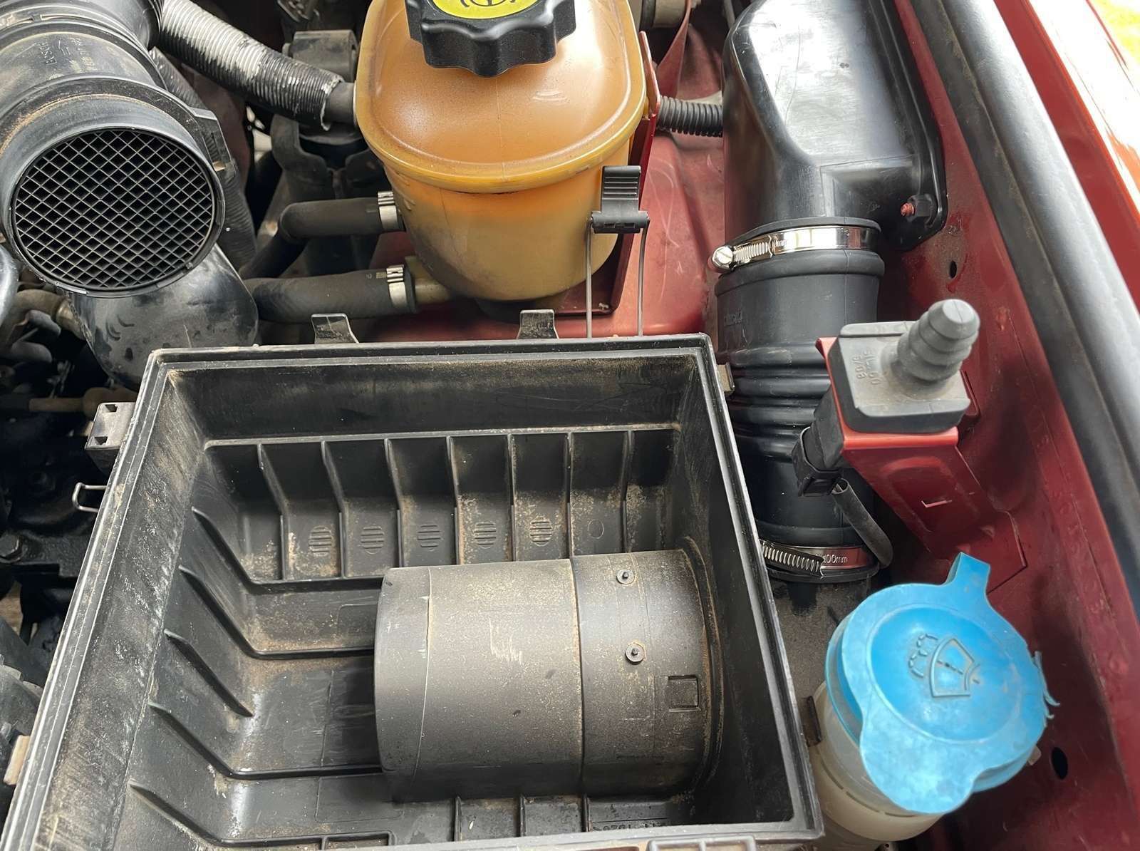

Today's fun was replacing the air intake tube. This is what the old one looked like:
https://cimg4.ibsrv.net/gimg/landrov...436fb72c0b.jpg
I ordered the CARRS4x4 replacement tube from Rovers North. It's a great kit and super easy to install, took me all of 15 minutes. Their instructions say to remove the airbox completely, that's not necessary at all. I just removed the airbox lid, unplugged the hood (bonnet) switch, and then removed the two 10mm bolts securing the intake to the side of the engine compartment. It was then very easy to remove the old, fabric and wire tube. You replace the old, crumbling felt gasket with a new high-temp silicone gasket:
https://cimg9.ibsrv.net/gimg/landrov...9869388fe6.jpg
Then you just push the tube onto the airbox and tighten the worm drive, put the other end of the tube on the fender intake, re-attach it to the fender with the 10mm nuts, and then tighten that worm-drive. Put the lid back on the airbox and plug the hood sensor back in.
https://cimg8.ibsrv.net/gimg/landrov...cf1e533cdc.jpg
https://cimg0.ibsrv.net/gimg/landrov...7ed7060640.jpg
I was going to replace the air filter too but no one near me had one in stock. My local O'Reilly's will have one tomorrow morning so I'll replace it then.

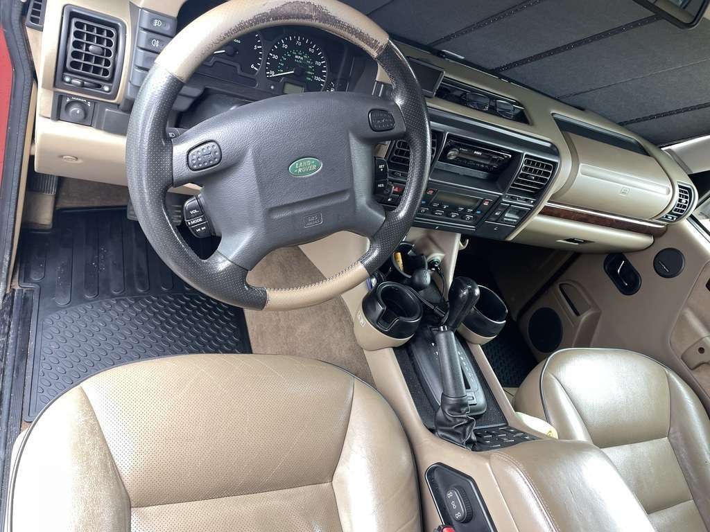

The top section of my steering wheel was worn and nasty looking and since it's a major touch point while driving, it bugged me every time I drove it. Enter Extinct Motorsports and their leather dye and crack filler. LINK
I know it's designed for seats, which is what I got it for, but dayum if it didn't make my steering wheel look brand new!
The wheel before:
https://cimg0.ibsrv.net/gimg/landrov...20b2f3875b.jpg
And after "painting" it:
https://cimg7.ibsrv.net/gimg/landrov...ab5eb42136.jpg
