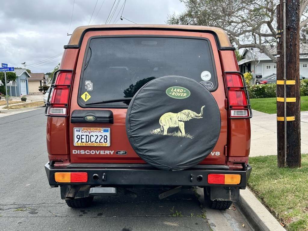

In today's installment of, let's make life suck, we installed a Lucky8 rear steel bumper. I got both the front and rear bumpers on Craigslist for a steal (steel?). The front isn't a huge priority, but the plastic on the rear bumper was falling apart badly.
My wife and I did the job, but it's really a job for two strong guys. I still need to reinstall the hitch, but I need to shift the bumper a bit and it was getting late. At least it's on there. Still need to reinstall the two trim pieces, one popped off and a couple of the plastic "Christmas trees" broke.

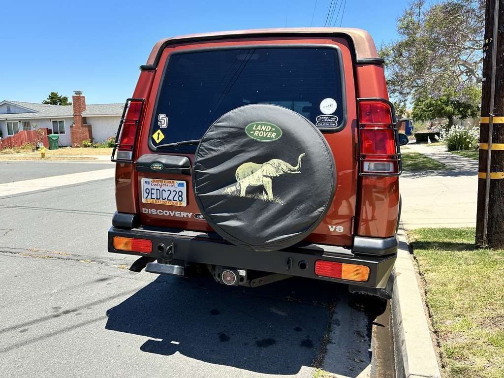

This morning I finished the rear bumper job. I loosened the two 19mm bolts holding the bumper to frame and was able to shift it slightly to the driver's side so the hitch bolt holes lined up. Then I just lifted the hitch into place with the jack and everything bolted up easily.
https://cimg7.ibsrv.net/gimg/landrov...7894bd0b02.jpg
The rear corner trim pieces took a bit of figuring out how to install without breaking the little "Christmas tree" fasteners. The trick is to install the front one into the body of the truck, position the trim piece so the slot is lined up with the tab sticking out, and then slide the trim piece forward onto the truck. I only broke one fastener before I figured it out! Everything is lined up really nicely now.

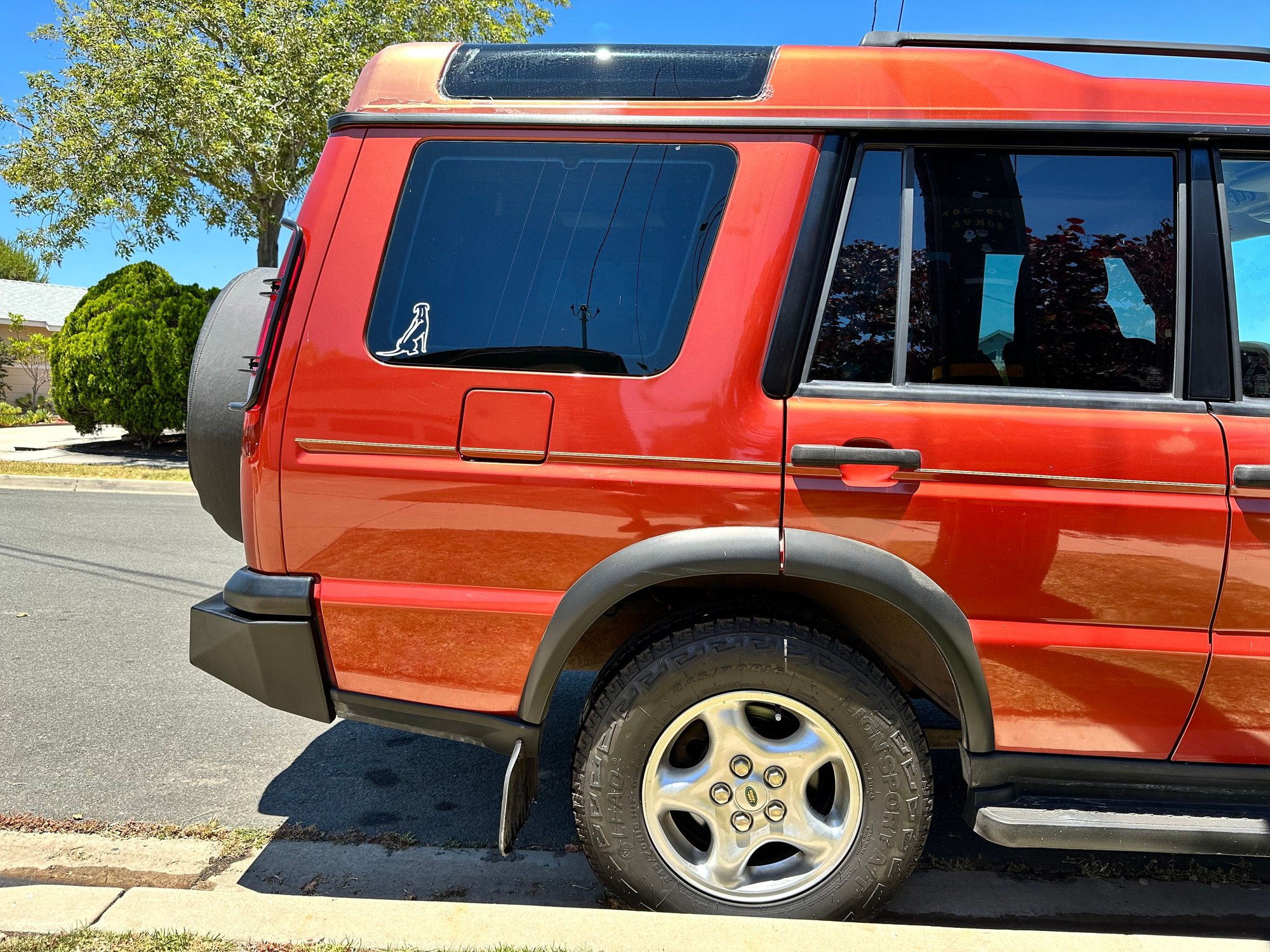

Added the rear access ladder today and removed the nasty tint from the back window. The nutserts that shipped with the ladder had very narrow shoulders and were totally inadequate. Fortunately, I have a nutsert kit and grabbed four from my kit. The ladder itself is very well made (not oem) and seems very very sturdy. This picture was taken before the tint was removed. The previous owner had the windows tinted with very cheap limo tint which was next to impossible to see through, even during the day. I'll take care of other windows as time permits.
