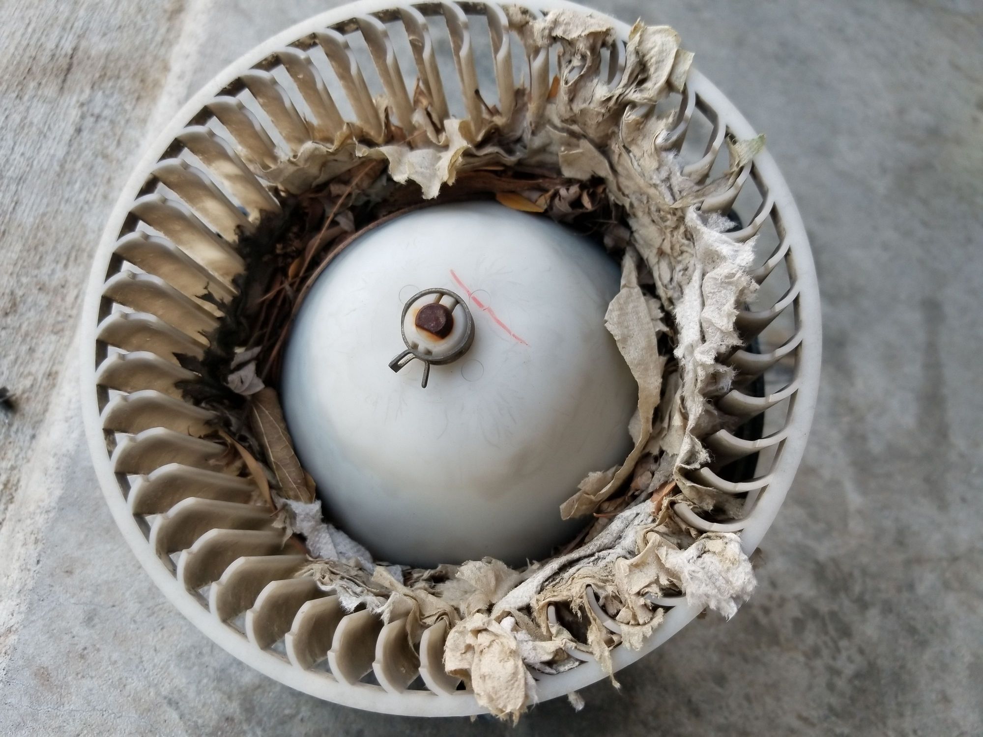

https://cimg4.ibsrv.net/gimg/landrov...153fc0fc9d.jpg The so-called squirrel cage. Had at least one squirrel's worth of hood liner felt in it. After cleaning and re-installation it purred like a kitten. |
That looks so comfortable I'd live in it.......
Once you've done it a couple of hundred times you don't even need to remove the glovebox, just lean in and go at it. I removed the hood insulation, first thing I did when I bought mine. |
That thing needs a shave!! :popcorn:

I did this today. Wow. Thought i was going to have to replace the motor until i read this thread and cleaned out the fan. Much, much quieter and blows harder than ever. Great thread!
