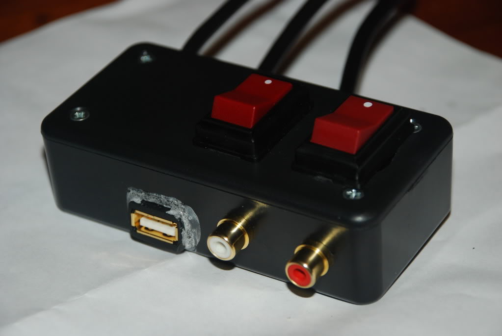

The project box I built on which to mount the switch is in my cubby and I drilled a hole in the cubby to get the wires under the passenger seat where the CD player is located. I used two DPDT witches. One for each channel of audio but I believe if you just tie all the negative audio lines together from both inputs and the wires back to the head unit, you can switch only the positives and get away with one rocker switch. Notice that I put RCA jacks on my project box in order to accommodate any type of MP3 player. I also installed a female USB port in order to power the MP3 player (which happens to be an iPod in this case).
Attachment 42562
The result is crystal clear sound from my iPhone and it charges it at the same time!

This is awesome. Any pics of where/how you made the connections?
WaltNYC Sep 11, 2012 11:09 AM
Fish, I started my project with a different design in mind, but have since come to the conclusion that I did too much work.
If I were to do it again I'd snip the CD cable about 2 feet from the CD player under the passengers seat. Then reconnect all the pins/wires #5-13 (and ground). How you connect them will vary based on how much slack you have and how much soldering/shrink tubing/electrical taping you want to do.
Then toss some female RCA's on both sides (one side on those wires leading to the head unit and the other side leading to the CD player) of audio lines (wires 1-4). Using standard 'RCA patch cords' which can be found in any Radioshack, I'd run them to a switch box in the cubby. On that box I'd have three sets of female RCA's. One set to go the head unit, another to go to the CD player, and the third to accept the input of the MP3 (or any other audio device for that matter). You could always hard wire those audio lines from the CD player cable to the switch box but I prefer to have something modular which I can remove.
I couldn't find a switch which would handle three wires each from two inputs (and send it to one output), so mine has two switches. One for the right and one for the left channel of audio.
Finally, for power, I tapped the cigarette lighter, installed another receptacle, bought a charger that would accept a USB cable. A USB cable with a female end at the switch box carries power to the device.
In the end I have R+L RCA jacks and a powered USB (get a 2.0 amp charger if you want to run iPad or latest iPhones) on the switch box in the cubby.
Hope that helps clear up some of the details.
