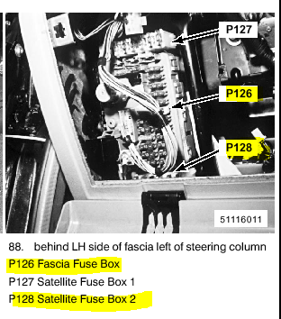

https://cimg9.ibsrv.net/gimg/landrov...5f3316459b.png
Did you check both fuses; F3 Main fuse box (dash/fascia fuse box) & F6 Satellite Fuse Box 2?
If both are OK you might want to try disconnecting the battery for a few hours and then enter the CODE again. I had to do that on a '95 RRC.
