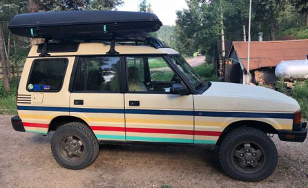

Is this the Jamacian lookin' one on Denver CL?
What concerns me is that if it is only $200 to fix the cat with an aftermarket solution, why would they just do it? :dunno:

OverRover Aug 13, 2018 09:56 AM
Sat is right!!!
BUT if you just have to own this :poop: pay NO MORE than $500 and a half a bag of weed.
This thing is a POS > https://denver.craigslist.org/cto/d/...648742222.html

whiskeynipple0088 Aug 13, 2018 12:27 PM
Not sure if Id consider it a POS anymore then any other non restored Disco of that age. However, wtf is with the paint? That kinda of stuff makes me very concerned about the knowledge and ability of work the original owner performed themselves - mainly the head job and the water pump. If done by a shop I would want to see the records-if by him, then no sale without compression check. (bad head job could be causing loss of compression=loss of power.) Also a going bad tranny may seem like loss of power too. I did'nt see any mention of fluid changes or filter changes.
But on the same hand there has been alot of good maintenance done so far.
Going into this you MUST be able to work on your own vehicles and understand its not a toyota and never will be. BUT they are easy to work on, parts are cheap and this and other sites have tons of knowledge and people willing to share it.

rogers Aug 17, 2018 04:59 PM
Ok, thank you everyone, for the responses. I went and checked it out. Yes it's the Denver CL one. Here's what I saw/experienced:
Doesn't make power well, which the seller said could be the cat
Won't go into four low, needs a new transfer case
Power seat switches are broken, which isn't a huge deal but I can't drive the thing with how far back the seats are right now.
Exhaust leak, not sure what the cause is.
The interior is in good shape and the guy seemed honest and reasonable about it's current state.
I'm fine with doing the work but I am wary of how many issues there seem to be. Maybe worth it for a grand and a few weekends of work to get it running properly?

Good thought on the head job. Owner seemed to know wtf he was talking about, maybe I'm a fool to trust. I kind of love the rhino paint! Maybe it's just me too ... :) Thank you for the help Whiskey Nipple!
stillruns Aug 17, 2018 10:03 PM
Aside from the color blind guy that painted it, the answer to your question is no. Do not buy it to be your daily driver on mountain roads in the middle of nowhere.
