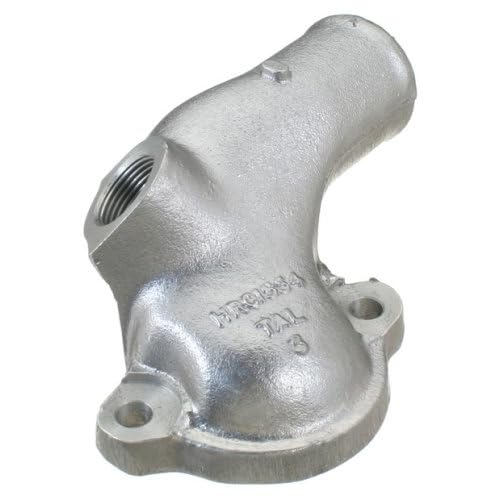

10-1 odds it's your thermostat, since what you describe are the typical stuck thermostat symptoms. Cheap $8 fix if that's the case. Changing the thermostat is extremely simple. On the passenger side of the vehicle, your radiator hoses connects the thermostat housing which looks like this:
http://ecx.images-amazon.com/images/...sL._SS500_.jpg
Remove the radiator hose from the housing, then remove the 2 retaining bolts and lift up the housing. The thermostat will either just be sitting there, or stuck to the housing itself with goop hanging from it. Replacement is as simple as cleaning the housing, and sitting the new thermostat and gasket in the hole, tighten the bolts and replace the radiator hose. 20 minutes your first time. Your wife can do it if you prefer! :D
